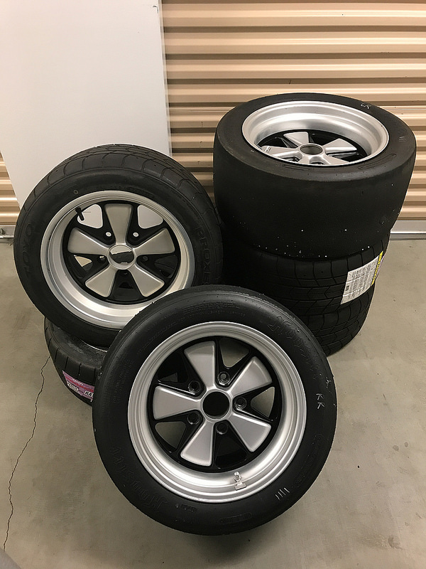

I've been hearing for years that 16x6's -- which used to be the cheap undesirable ones -- have been swooped-up to make custom 3-piece 17's and so forth.
Here's part of my stash off and on the car. I exclusively use 15x8" Fuchs and 15x9 Braid now and have some black centered and some RSR style.
