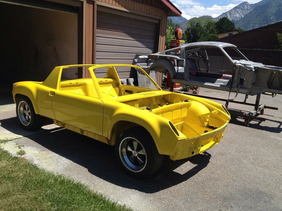

So this is a picture of #41 when it was just out of paint with real Fuchs 8x16 up front and 9x16 rear. I am picking up my finished Fuchs in the next day with 7x15 and 8x15s Polished paddles polished caps. I think I like the look better in 15 and my space saver is a 6x15 and I wanted them all to match plus I can sell my 8 and 9s and get money back.
I think the 8 and 9 -16 look the same and the car looks better in the staggered look even if they where staggered they just did not look like it by the wheels at 8s and 9s
Natcho wants the 8s
Bob B
