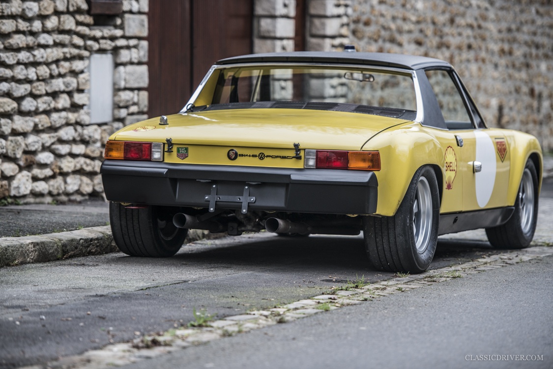

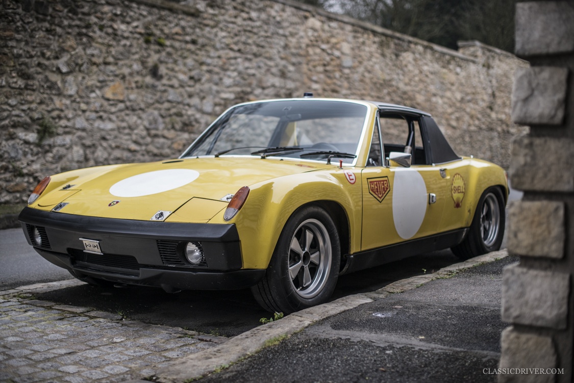

^^^ Cool! Thank you for the info (IMG:style_emoticons/default/smile.gif)
Here are a couple more pics! What size are these VVV ? (IMG:style_emoticons/default/popcorn[1].gif)
