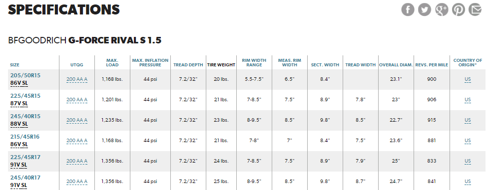

Tire sizing chart for the Rival, its also DOT rated 200 treadwear. But get's traction similar to a 100 tw tire.
