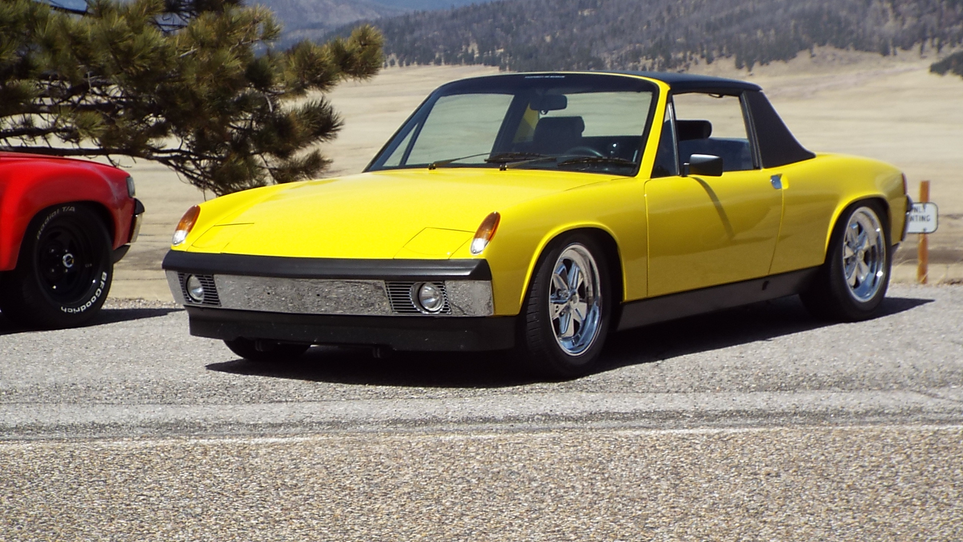

ConeDodger   So far I’m the only 7X16 front 9X16 rear. My rea...   Jan 19 2018, 05:35 PM
Spoke   So far I’m the only 7X16 front 9X16 rear. My re...   Jan 19 2018, 05:59 PM
ConeDodger   So far I’m the only 7X16 front 9X16 rear. My r...   Jan 20 2018, 04:19 PM
