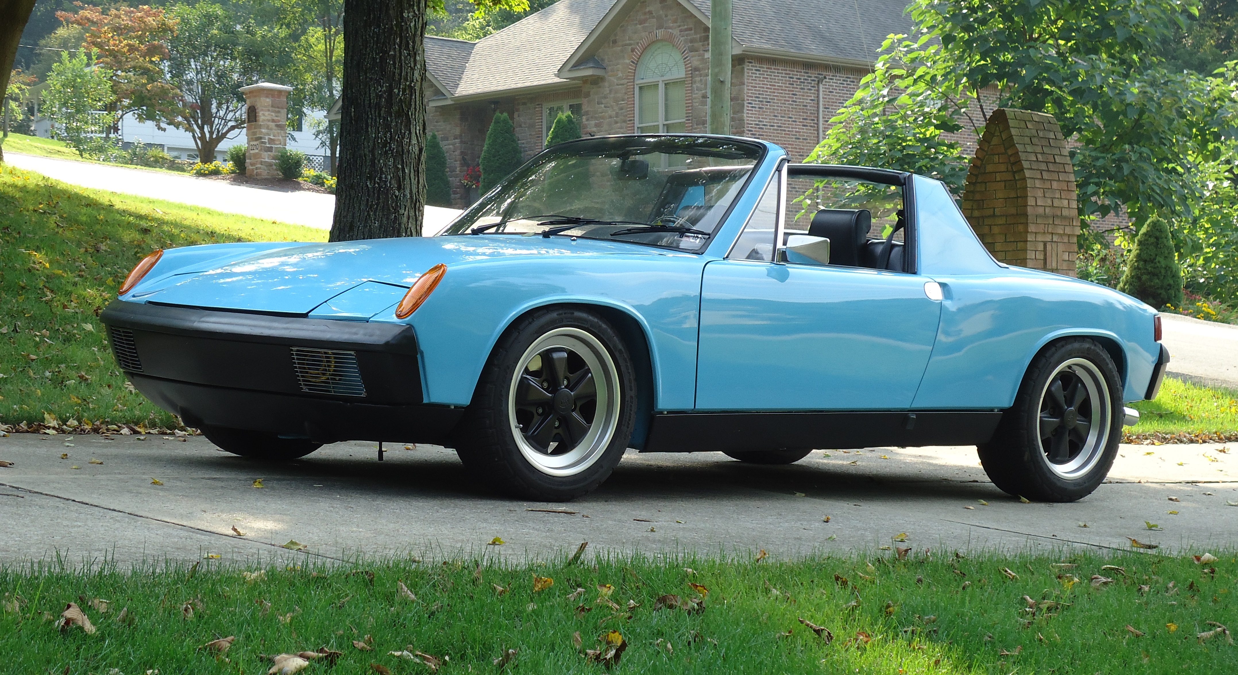

Another 7x16 Front, 8x16 Rears. 951 wheels 23.3 offset. both ends.
Tires are 205/50-16 front and 225/50-16 rear.
Tangerine flares on both ends, need the 23 offset wheels on the rear to clear these tires.
it does sit a little high in the rear. I will drop it down someday....
