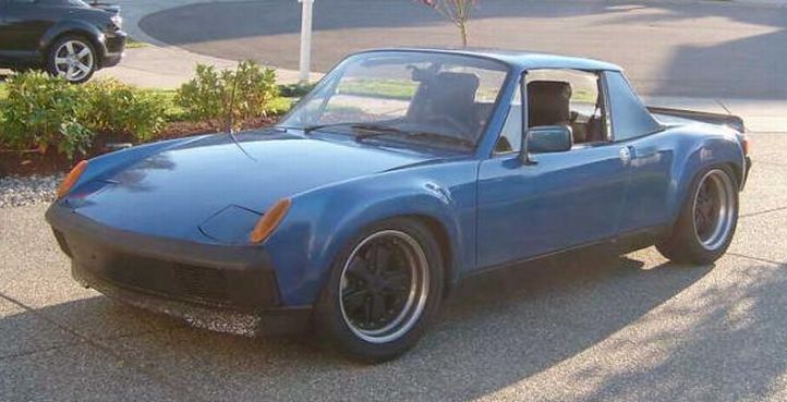

I think I have covered the most common Fuchs wheel size combos for a GT tribute or clone. This would be for aggressive street and possibly light track use. Pick a wheel size combo that you think looks best in your opinion. Then list your reasons ... (IMG:style_emoticons/default/beerchug.gif)

same blue 914 steel 'top with 7$8 x 16 3 piece fuch center wheels,,I own the wheels now

sixnotfour   same blue 914 steel 'top with 7$8 x 16 3 ...   Feb 2 2018, 02:57 AM
