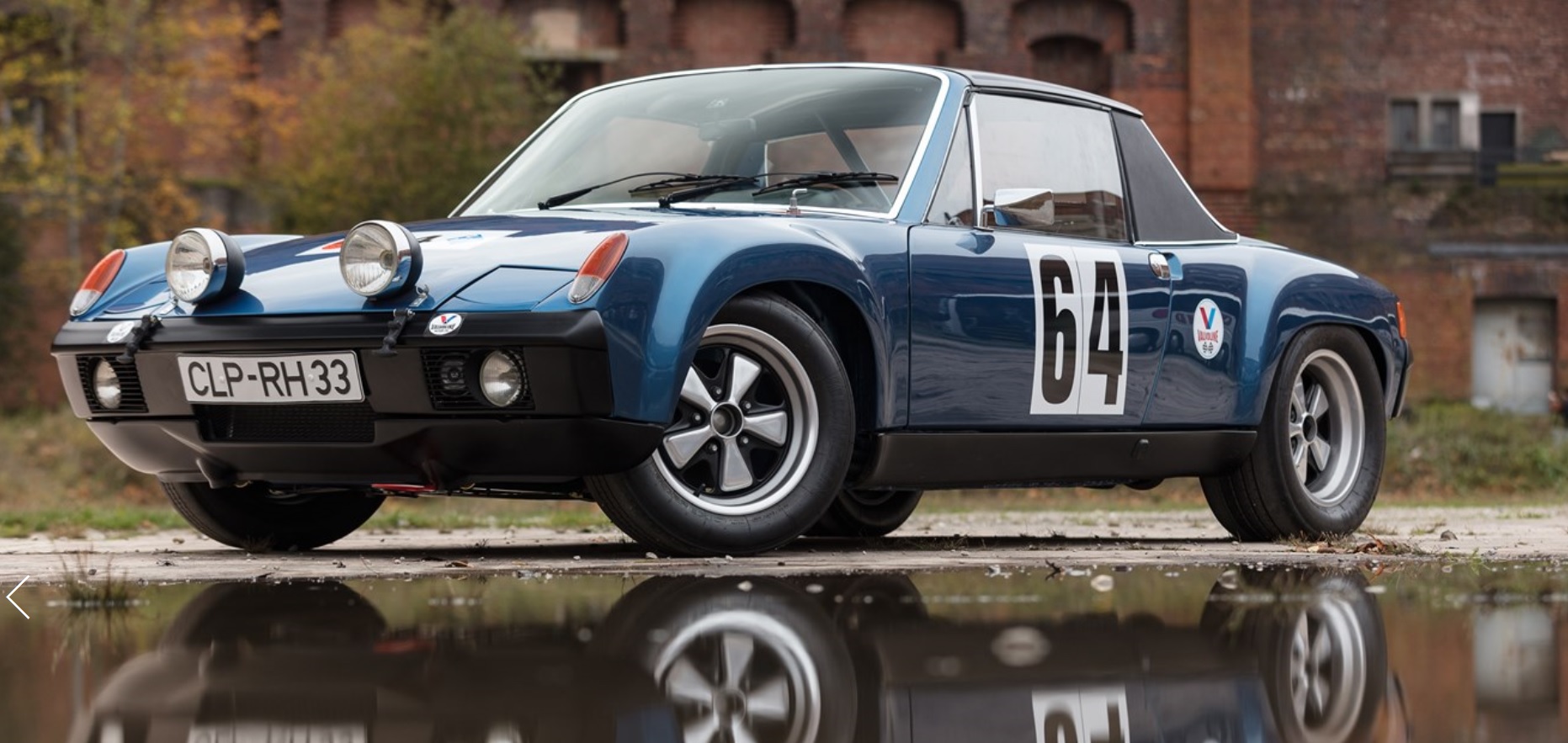

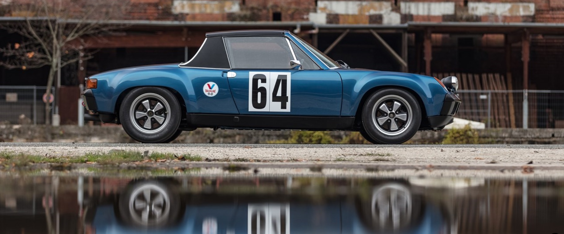

sixnotfour   same blue 914 steel 'top with 7$8 x 16 3 ...   Feb 2 2018, 02:57 AM

VegasRacer   According to the pole, Elvira is the only one runn...   Feb 6 2018, 08:32 PM
Justinp71   According to the pole, Elvira is the only one run...   Feb 7 2018, 12:33 AM
sixnotfour   According to the pole, Elvira is the only one ru...   Feb 7 2018, 02:02 AM
