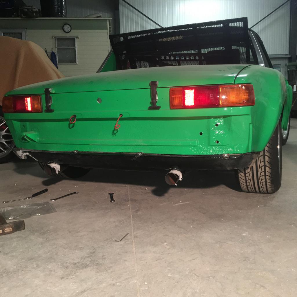

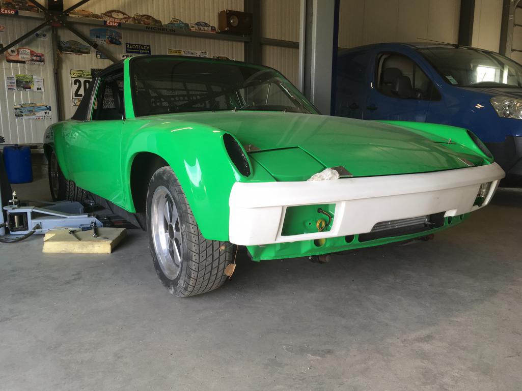

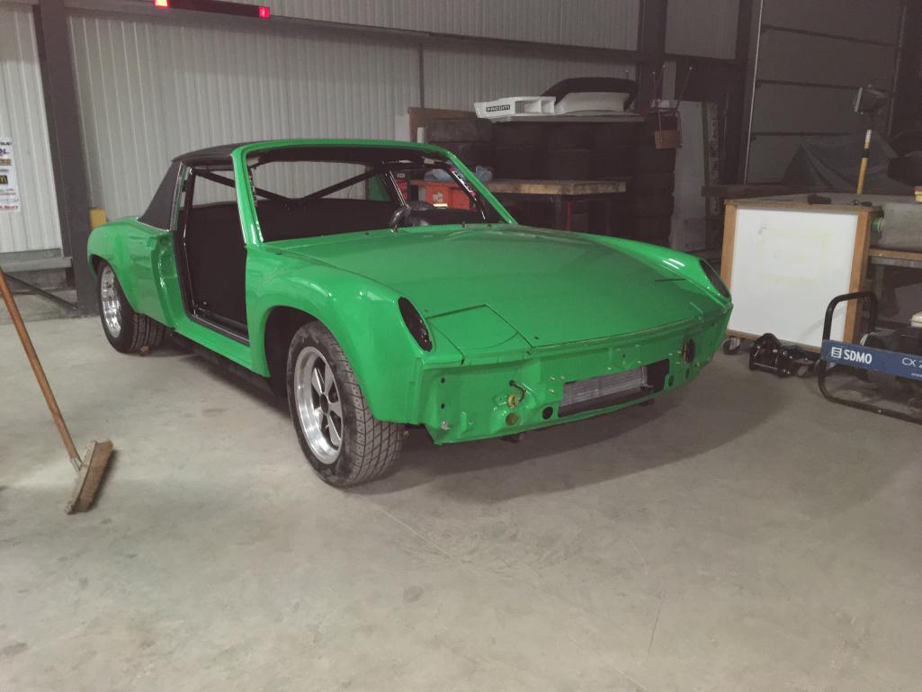

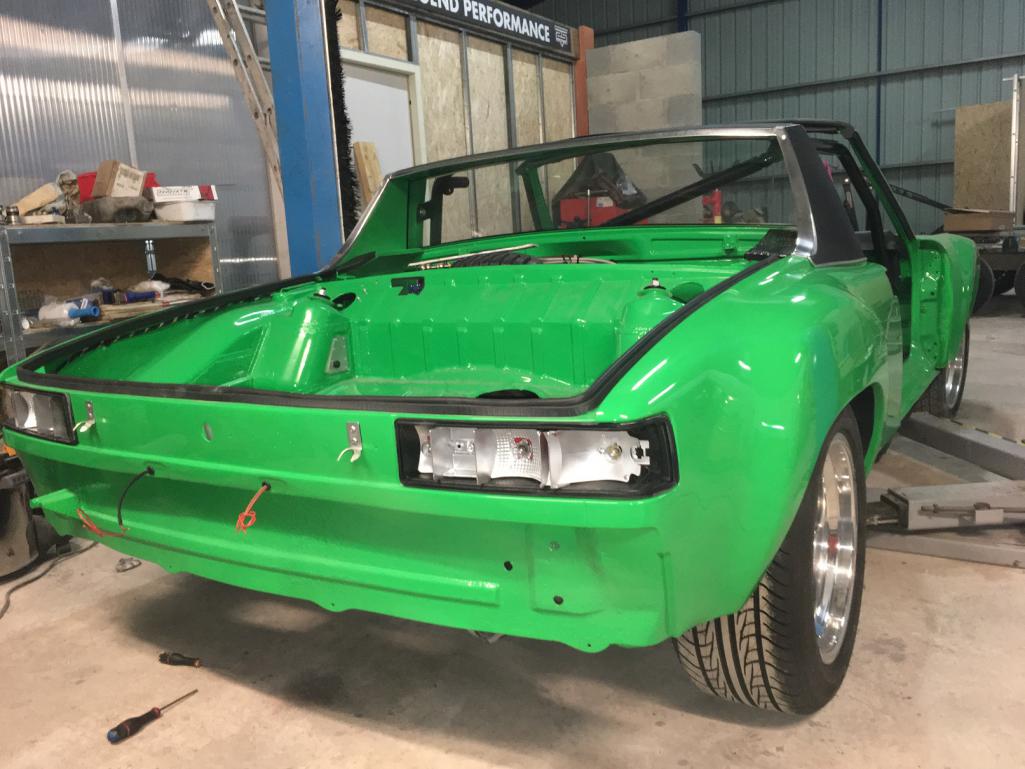

So in that theme, here are some pics sourced from erwan914's thread here:
http://www.914world.com/bbs2/index.php?showtopic=301336
He is running 7 & 8 x 15 fuchs with tire sizes:
front 205/50/15
rear 225/50/15
