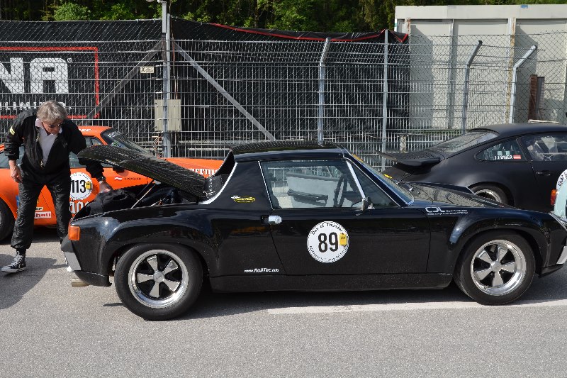

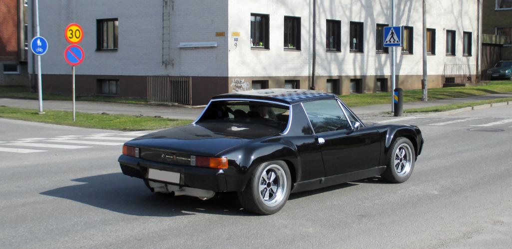

Anyone want to guess tire sizes on these black beauties below? (IMG:style_emoticons/default/sunglasses.gif)
