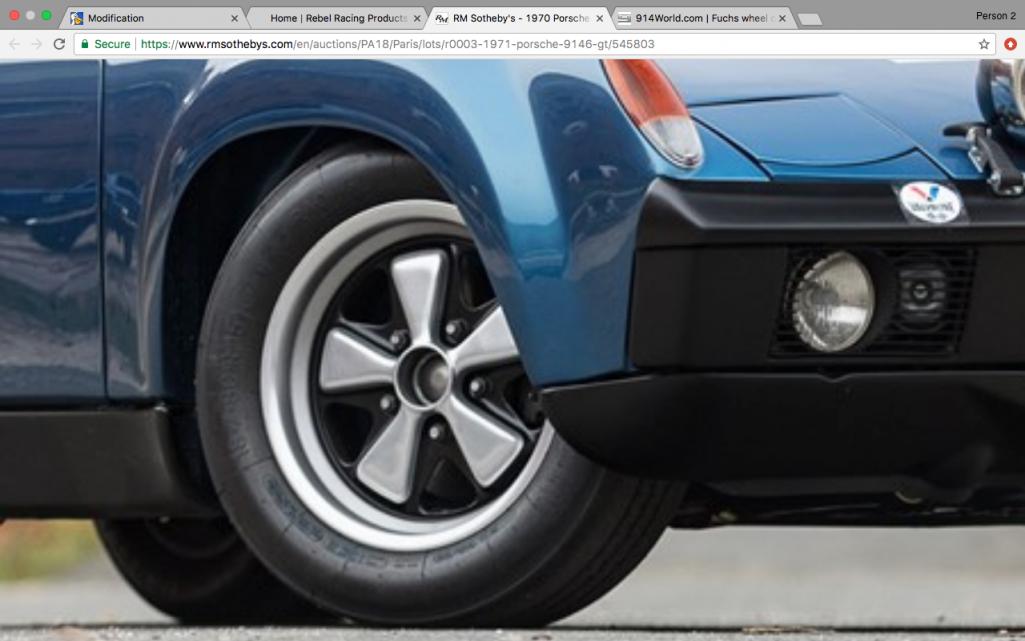

gothspeed...
Yep I tried to zoom in too and it's not easy to see... (IMG:style_emoticons/default/biggrin.gif)
It may be running some type of race tires...since some come in different size designations..
Like in the Dunlop and Avons...
I've used Hoosier and Goodyear racing tires in the past for the track and they had some wierd sizing numbers...you just have to get all of the tire dimensions and then choose accordingly. And sponsorship money helps pay for them (IMG:style_emoticons/default/biggrin.gif)
I really like seeing all of these GT pictures (IMG:style_emoticons/default/biggrin.gif)
post Feb 8 2018, 06:44 AM
914-6 GT in waiting
Posts: 20,916
Joined: 19-September 09
Member No.: 10,825
QUOTE(johnhora @ Feb 7 2018, 10:25 PM) *
gothspeed...
On the Blue GT car, the rear is 23/62R/15
I can't quite make out the front
18/80R/15 ?
