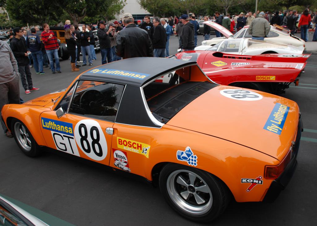

QUOTE(mepstein @ Feb 8 2018, 12:37 PM) *
Orange one is chris's/campbellcj car
Chris needs to post his tire recipe! (IMG:style_emoticons/default/smile.gif)

gothspeed   The orange car has nice looking wheel/tire choices...   Feb 8 2018, 02:18 PM
mepstein   Orange one is chris's/campbellcj car   Feb 8 2018, 02:37 PM
campbellcj   Orange one is chris's/campbellcj car Hi al...   Feb 8 2018, 09:58 PM
gothspeed   [quote name='mepstein' post='2576623' date='Feb 8...   Feb 9 2018, 10:08 AM
campbellcj   Thanks for posting tire sizes. I looked those up...   Feb 9 2018, 11:32 AM
