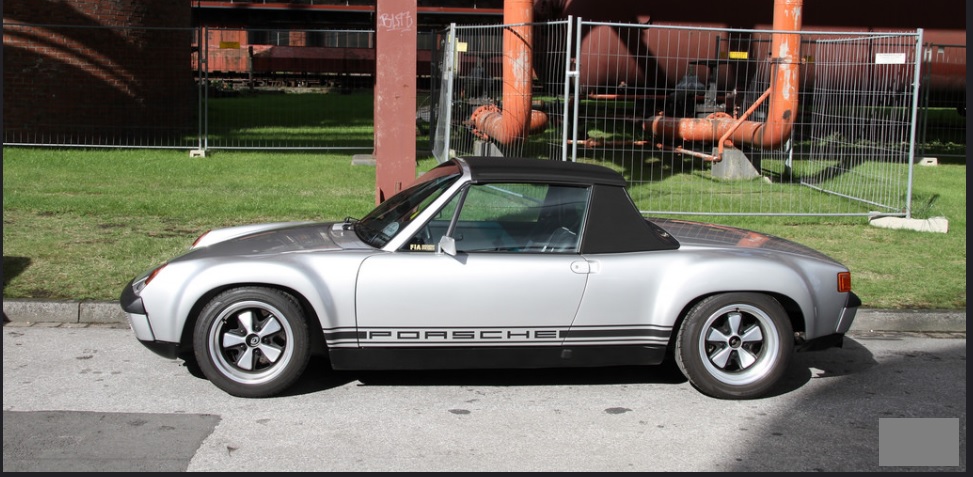

As a few people have mentioned there are few options for wider 15" tires. It seems 7s & 8s x15 are not only the most popular choice in the poll but also has better street tire options.
Here is another GT with 15s ... (IMG:style_emoticons/default/smile.gif)
