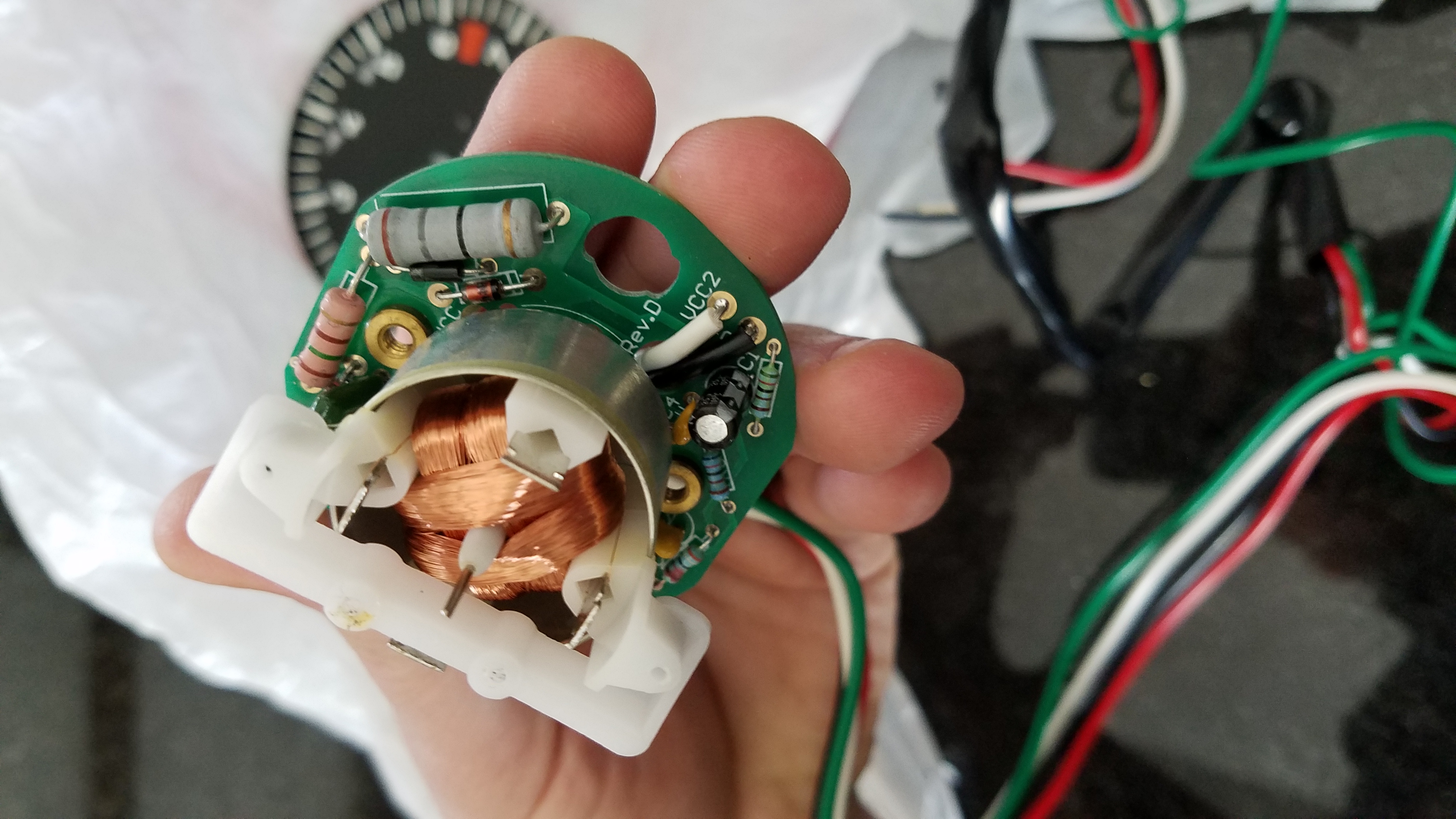

Good news for anyone wanting to do this. I recently picked up a Bosch mini tach and stripped it down. Looks to be the identical guts.
Bosch FST 7904

Optimusglen   Good news for anyone wanting to do this. I recentl...   Mar 14 2018, 11:48 AM
