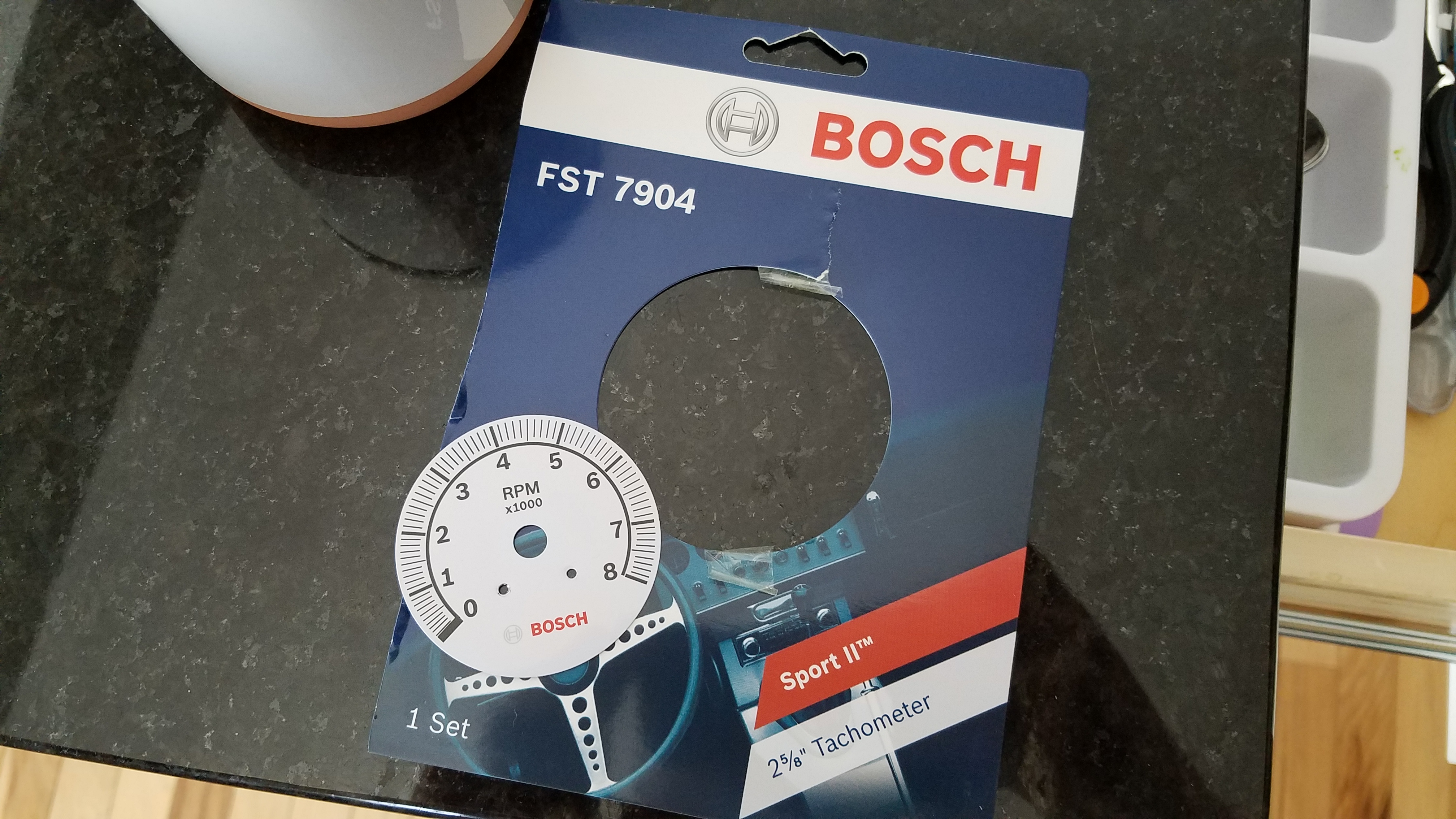

Packaging and face
.Attached Image

Optimusglen   Good news for anyone wanting to do this. I recentl...   Mar 14 2018, 11:48 AM
Optimusglen   Packaging and face .   Mar 14 2018, 12:00 PM
