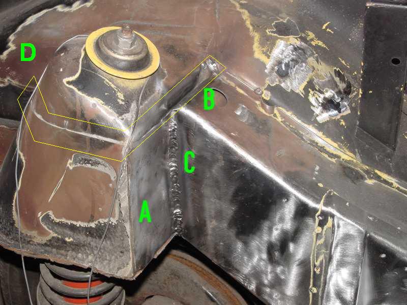

Didn't get to work on the 914 as much as I hoped over my vacation, but still made some good progress over the last couple of days...
Frame rails in the engine comp. are stripped naked
They still need some minor detailing here and there and the "hell holes" still need to be cleaned, but most of the hard work is done
Tonight I welded the rear shock towers to the frame rails
Quite a gap to fill...

So you are referring to all of the area highlighted in yellow plus an area that can't be seen in the picture, which would be just below the letter D, right.

Jeroen   Ok, I'll try and explain best as I can... In ...   Nov 16 2004, 06:32 PM
Jeroen   If you wanna keep the firewall in place, like Bran...   Nov 16 2004, 06:56 PM
hargray2   So you are referring to all of the area highlighte...   Nov 16 2004, 07:11 PM
