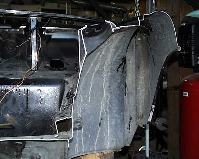

Eric_Shea   Me agrees with Brandt. Here's what we (Mike a...   Nov 16 2004, 06:14 PM
brant   I know I said that I'd shut up, but oh well......   Nov 16 2004, 06:23 PM
Jeroen   Ok, I'll try and explain best as I can... In ...   Nov 16 2004, 06:32 PM
Jeroen   If you wanna keep the firewall in place, like Bran...   Nov 16 2004, 06:56 PM
hargray2   So you are referring to all of the area highlighte...   Nov 16 2004, 07:11 PM
URY914   Jeroen, Isn't the sheet metal on the shock to...   Nov 16 2004, 07:16 PM
URY914   I'm going to cut my firewall out. and I'm ...   Nov 16 2004, 07:20 PM

davep   I think a fully dissected set of views would be re...   Nov 17 2004, 12:41 PM
Jeroen   Here's the disected shocktower pic This is ju...   Nov 17 2004, 01:11 PM
URY914   That is a great shot.   Nov 17 2004, 01:14 PM
Jeroen   Some sawzall pics, courtesy of Mike Mueller Drive...   Nov 17 2004, 01:23 PM

Gint   We had a sawzall party yoday and I disected a fram...   Nov 27 2004, 06:13 PM
Gint   This is the opposite side showing how the inner fe...   Nov 27 2004, 06:15 PM
Gint   I'm the proud owner of that section of tub, so...   Nov 27 2004, 06:26 PM
Brad Roberts   That is ok. I'm still waiting to breath. I...   Nov 27 2004, 06:30 PM
Gint   The one I just posted the pictures of was a 72 (02...   Nov 27 2004, 06:31 PM
