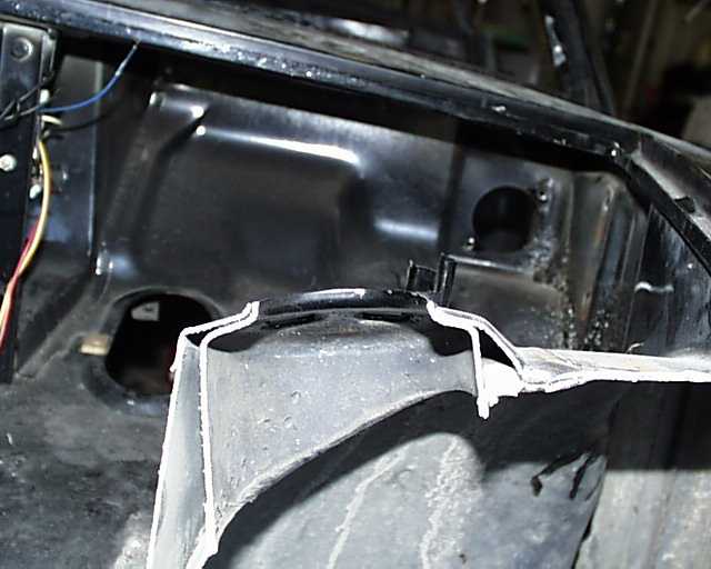

Jeroen   Here's the disected shocktower pic This is ju...   Nov 17 2004, 01:11 PM
URY914   That is a great shot.   Nov 17 2004, 01:14 PM
Jeroen   Some sawzall pics, courtesy of Mike Mueller Drive...   Nov 17 2004, 01:23 PM
Jeroen   drivers side front shoch tower   Nov 17 2004, 01:23 PM
Jeroen   drivers side front shock tower - close up   Nov 17 2004, 01:24 PM
Jeroen   firewall (passenger/engine)   Nov 17 2004, 01:24 PM
Jeroen   rear trunk, x-section of the dogbone, near the tra...   Nov 17 2004, 01:24 PM
Jeroen   last one... Targa/roll bar inner reinforcement   Nov 17 2004, 01:25 PM

Gint   We had a sawzall party yoday and I disected a fram...   Nov 27 2004, 06:13 PM
Gint   This is the opposite side showing how the inner fe...   Nov 27 2004, 06:15 PM
Gint   I'm the proud owner of that section of tub, so...   Nov 27 2004, 06:26 PM
Brad Roberts   That is ok. I'm still waiting to breath. I...   Nov 27 2004, 06:30 PM
Gint   The one I just posted the pictures of was a 72 (02...   Nov 27 2004, 06:31 PM
