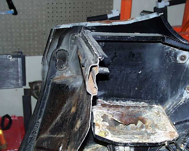

Didn't get to work on the 914 as much as I hoped over my vacation, but still made some good progress over the last couple of days...
Frame rails in the engine comp. are stripped naked
They still need some minor detailing here and there and the "hell holes" still need to be cleaned, but most of the hard work is done
Tonight I welded the rear shock towers to the frame rails
Quite a gap to fill...

firewall (passenger/engine)

Lou W   Wow, I never realized how those towers are attache...   Aug 16 2004, 12:04 AM
Brad Roberts   You got it. The GT stiff kit pieces that go insid...   Aug 16 2004, 12:14 AM

rdauenhauer   I confused :wacko: w/o seeing the original back ...   Aug 16 2004, 11:36 AM
Brad Roberts   It has small tabs that are folded over and spot we...   Aug 16 2004, 11:43 AM
Jeroen   Maybe this pic helps you get a better idea... Her...   Aug 16 2004, 05:07 PM

Jeroen   Ok, I'll try and explain best as I can... In ...   Nov 16 2004, 06:32 PM
Jeroen   If you wanna keep the firewall in place, like Bran...   Nov 16 2004, 06:56 PM

davep   I think a fully dissected set of views would be re...   Nov 17 2004, 12:41 PM
Jeroen   Here's the disected shocktower pic This is ju...   Nov 17 2004, 01:11 PM

Jeroen   Some sawzall pics, courtesy of Mike Mueller Drive...   Nov 17 2004, 01:23 PM
Jeroen   drivers side front shoch tower   Nov 17 2004, 01:23 PM
Jeroen   drivers side front shock tower - close up   Nov 17 2004, 01:24 PM
Jeroen   firewall (passenger/engine)   Nov 17 2004, 01:24 PM
Jeroen   rear trunk, x-section of the dogbone, near the tra...   Nov 17 2004, 01:24 PM
Jeroen   last one... Targa/roll bar inner reinforcement   Nov 17 2004, 01:25 PM

Gint   We had a sawzall party yoday and I disected a fram...   Nov 27 2004, 06:13 PM
Gint   This is the opposite side showing how the inner fe...   Nov 27 2004, 06:15 PM
Gint   I'm the proud owner of that section of tub, so...   Nov 27 2004, 06:26 PM
Brad Roberts   That is ok. I'm still waiting to breath. I...   Nov 27 2004, 06:30 PM
Gint   The one I just posted the pictures of was a 72 (02...   Nov 27 2004, 06:31 PM
