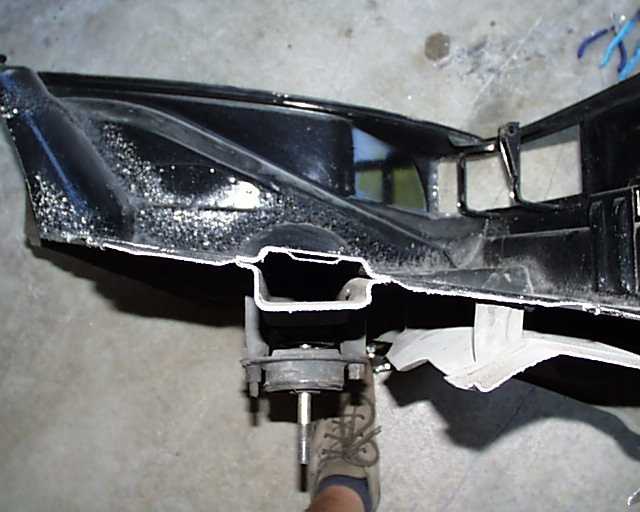

rear trunk, x-section of the dogbone, near the tranny mount

Jeroen   Some sawzall pics, courtesy of Mike Mueller Drive...   Nov 17 2004, 01:23 PM
Jeroen   drivers side front shoch tower   Nov 17 2004, 01:23 PM
Jeroen   drivers side front shock tower - close up   Nov 17 2004, 01:24 PM
Jeroen   firewall (passenger/engine)   Nov 17 2004, 01:24 PM
Jeroen   rear trunk, x-section of the dogbone, near the tra...   Nov 17 2004, 01:24 PM
Jeroen   last one... Targa/roll bar inner reinforcement   Nov 17 2004, 01:25 PM
