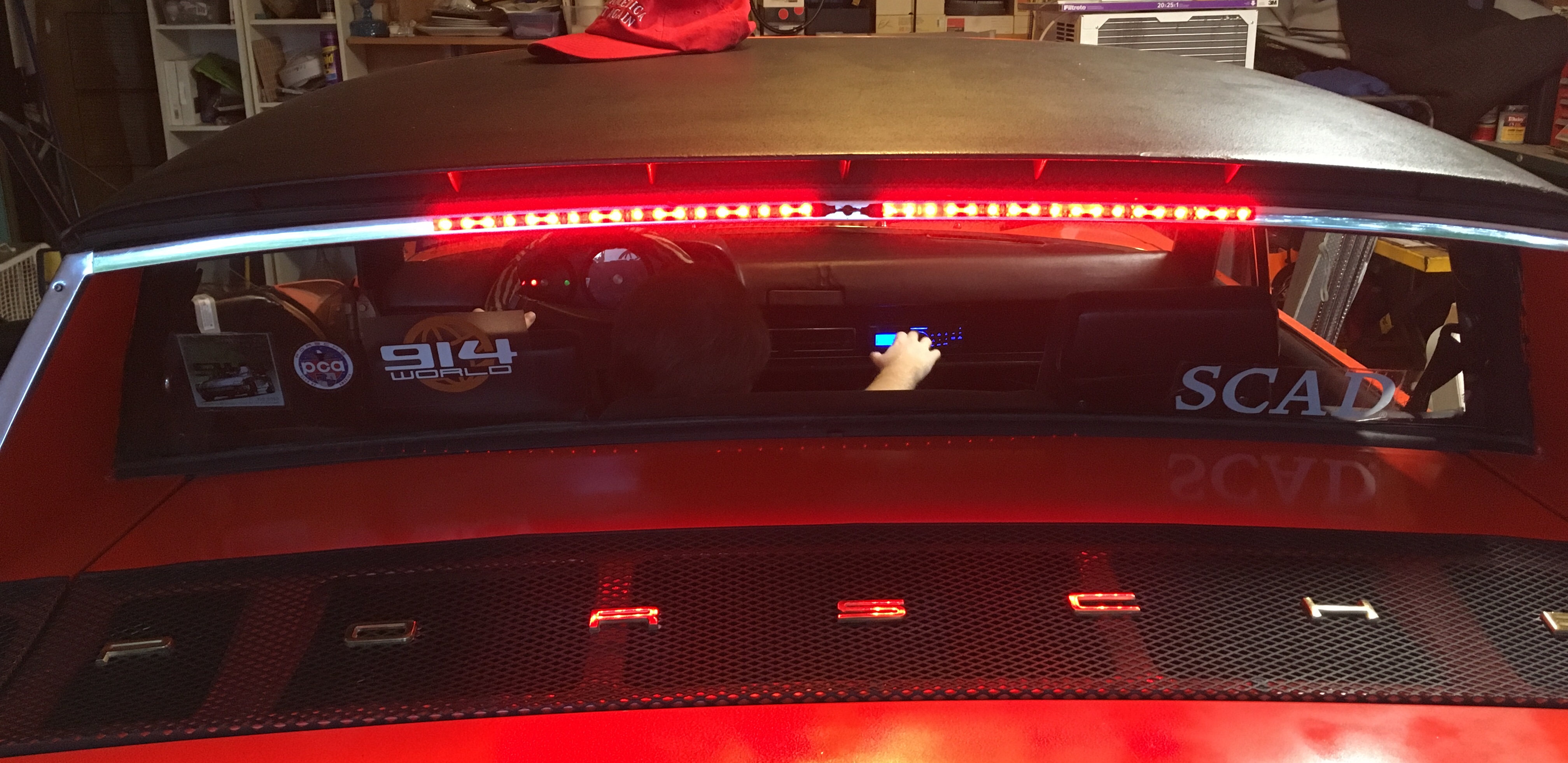

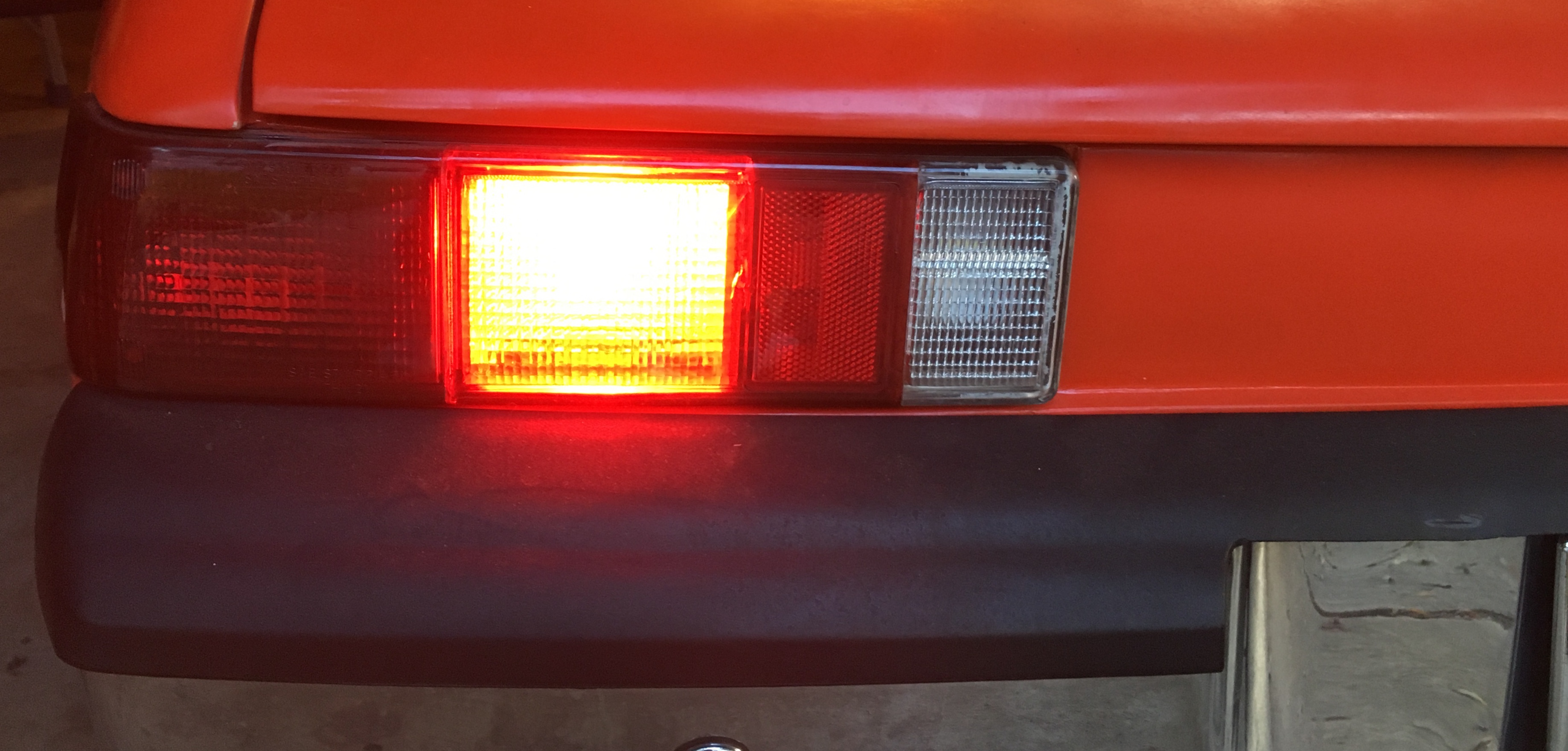

Step 1. $10 HF Dremel tool with needle size grinder tip. Clean all grounds in and out.
Step 2. Mask and chrome paint from Autozone for plastic.
Step 3. Super bright LED red bulbs. Add their crimp on resister for turn signals
(White for backup lights naturally)
Optional. 24” stick on red Led strip and pigtail into brake light wire. Drill a center hole in the trim. Add a rubber grommet and dab of silicon glue. And thread inside the chrome strip. ( these are 5 years old and still work great).
Save your money later and gat Spokes lights.
