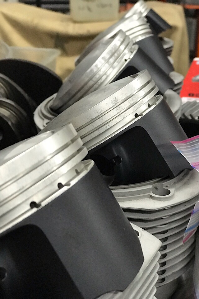

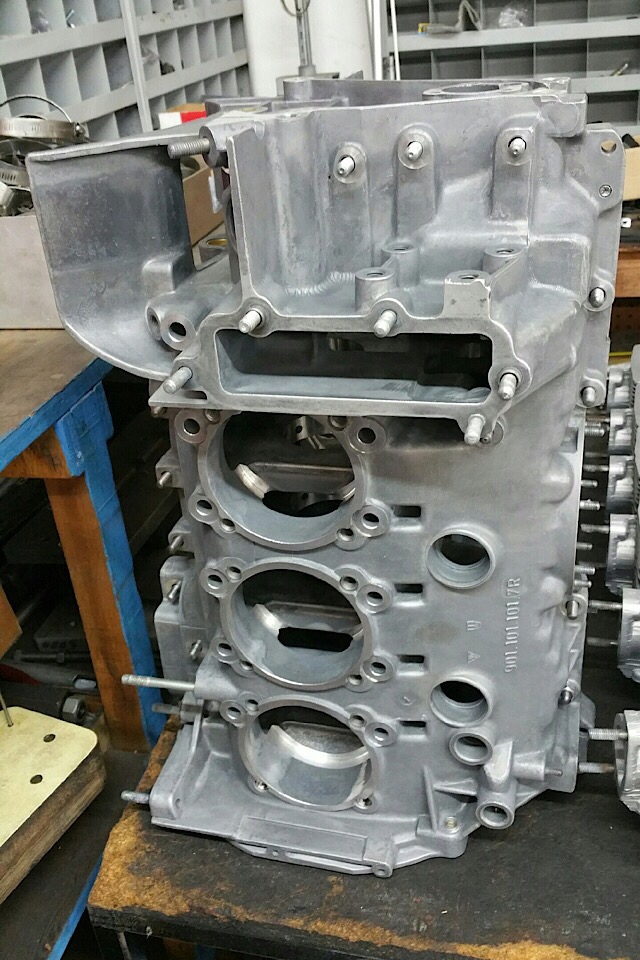

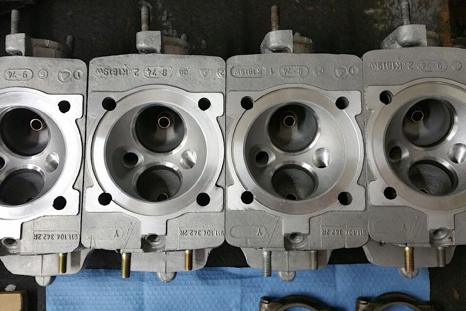

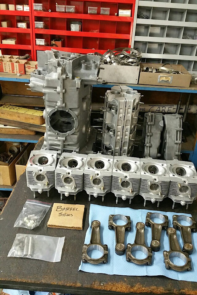

Engine back from Ollie’s. Case was media blasted, shuffle pinned, decked, with oil bypass mods. Heads ported, Valves installed, extra spark plug hole drilled. Pistons coated.
