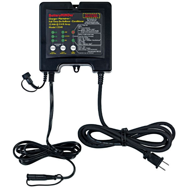

QUOTE(90quattrocoupe @ Jan 23 2019, 06:58 PM) *
I use this one. I got 10 years out of my trailer battery and 8 years out of the battery in my Audi.
(IMG:http://www.914world.com/bbs2/uploads_offsite/i.imgur.com-20561-1548298683.1.jpg)
BINGO! That's the one I have and use to maintain multiple batteries (at once). I also have one of their simpler trickle chargers w/ desulfation to hook to a single vehicle.
