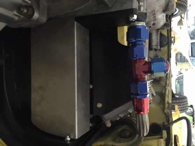

I have after market oil lines with AN fittings. The line from the tank to the cooler has a leak. Apparently at the cooler end. As I think about replacing the line, I’ve been thinking about putting in a fitting at the tank end with a valve or a threaded hole for a drain plug. Something to make draining the oil easier than disconnecting the hose. Anyone here ever done such a thing?

Sorry, pic is turned sideways. An next time I drain the oil, I plan to safety wire the cap. Even though it points down, this pic is without the heat exchangers installed. They sit at least a couple inches lower than the T.

gms   As confident as I am that I would never leave a va...   Jan 27 2019, 07:42 PM
Mark Henry   A Tee with an EZ drain would be the best. But...ev...   Jan 27 2019, 08:14 PM

gereed75   A simple solution is to drill a hole in the union ...   Jan 27 2019, 10:00 PM
GeorgeRud   The factory solution with a connection at the oil ...   Jan 28 2019, 09:43 AM
Mark Henry   The factory solution with a connection at the oil...   Jan 28 2019, 01:25 PM

MoveQik   I have the same set up as Mepstein and it has work...   Jan 28 2019, 01:32 PM
mepstein   I have the same set up as Mepstein and it has wor...   Jan 28 2019, 01:54 PM
targa72e   I have -16 lines and used this between the line to...   Jan 28 2019, 03:16 PM
