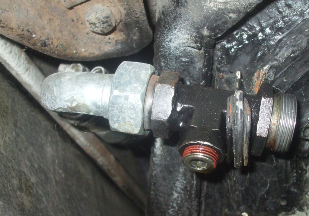

I have after market oil lines with AN fittings. The line from the tank to the cooler has a leak. Apparently at the cooler end. As I think about replacing the line, I’ve been thinking about putting in a fitting at the tank end with a valve or a threaded hole for a drain plug. Something to make draining the oil easier than disconnecting the hose. Anyone here ever done such a thing?

My solution. (IMG:style_emoticons/default/smile.gif)

mepstein   Sorry, pic is turned sideways. An next time I drai...   Jan 27 2019, 05:23 PM

Mark Henry   A Tee with an EZ drain would be the best. But...ev...   Jan 27 2019, 08:14 PM
mepstein   A Tee with an EZ drain would be the best. But...e...   Jan 27 2019, 10:26 PM

mb911   I have also made tanks with 911 drains before .. T...   Jan 28 2019, 09:56 AM
MoveQik   I have the same set up as Mepstein and it has work...   Jan 28 2019, 01:32 PM
mepstein   I have the same set up as Mepstein and it has wor...   Jan 28 2019, 01:54 PM
targa72e   I have -16 lines and used this between the line to...   Jan 28 2019, 03:16 PM
