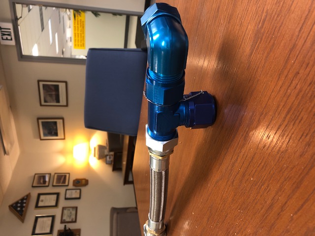

I have after market oil lines with AN fittings. The line from the tank to the cooler has a leak. Apparently at the cooler end. As I think about replacing the line, I’ve been thinking about putting in a fitting at the tank end with a valve or a threaded hole for a drain plug. Something to make draining the oil easier than disconnecting the hose. Anyone here ever done such a thing?

New line I had made is ready to go in

jfort   Hose taken to hose maker. It was leaking at the co...   Feb 1 2019, 08:46 AM
