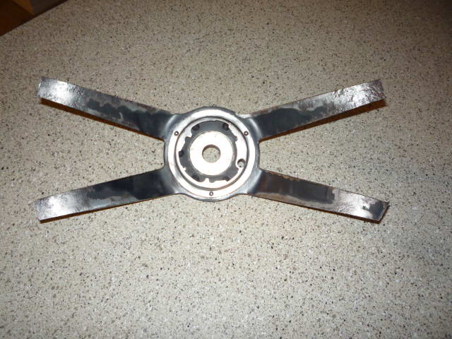

> Modified 914 or 911 RS Type steering wheel (my version), 30mm grip, 340mm Dia , 40mm deeper than stock

In the works....
I like these steering wheels with RS / GT type centers but even the 360mm Dia wheels are a tad big IMO
Honey...I'm shrinking my steering wheel. (IMG:style_emoticons/default/happy11.gif)
To be continued.....

ValcoOscar   More photos showing size differences. Opted not t...   Mar 19 2019, 09:39 PM

ValcoOscar   It took me several attempts and unfortunately I sc...   Mar 20 2019, 08:27 AM
Mark Henry   It took me several attempts and unfortunately I s...   Mar 20 2019, 08:46 AM
gereed75   My plan was to cut the rim portion out of flat sto...   Mar 20 2019, 08:43 AM
ValcoOscar   My plan was to cut the rim portion out of flat st...   Mar 20 2019, 08:49 AM

ValcoOscar   One finished.... :dance: :monkeydance: 30mm Gr...   Feb 9 2020, 07:46 PM

ValcoOscar   Finished one of my modified steering wheels for a ...   May 20 2020, 10:28 PM

ValcoOscar   Back at this...now I'm adding thumb rests afte...   Feb 13 2021, 06:09 PM
