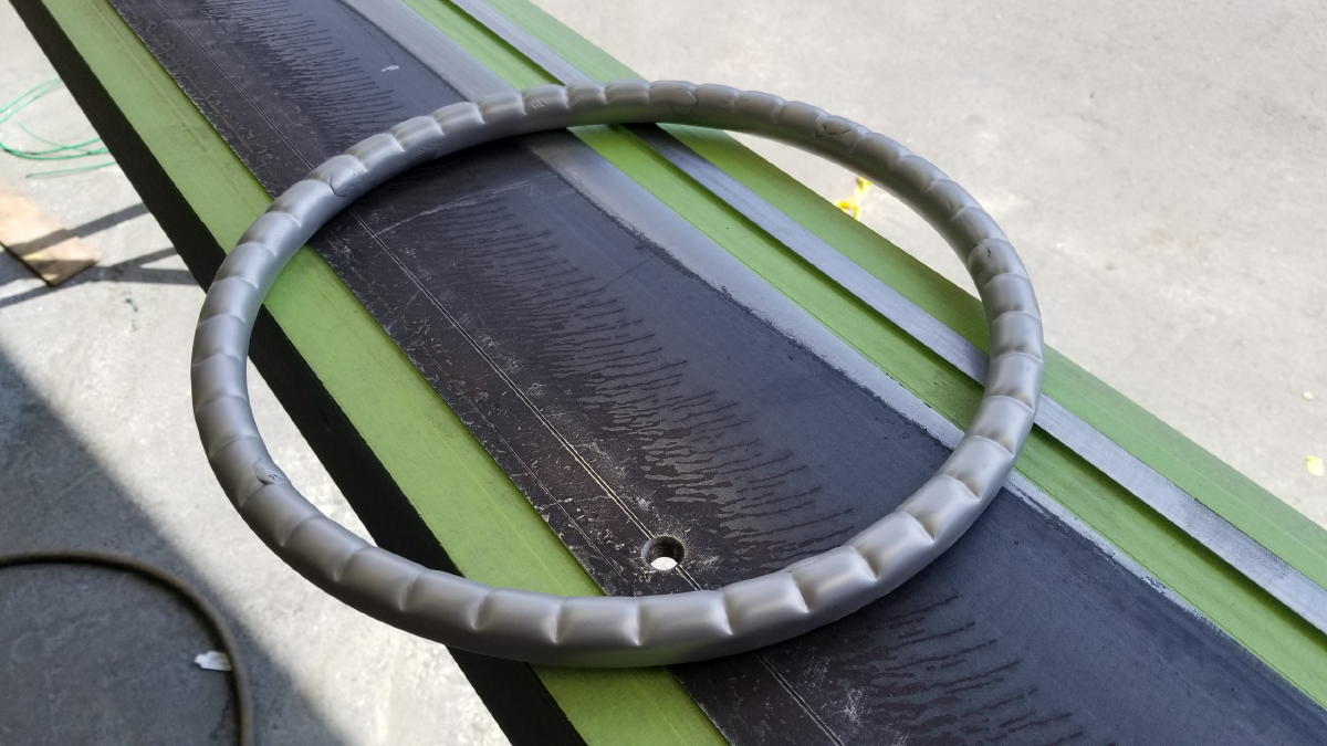

> Modified 914 or 911 RS Type steering wheel (my version), 30mm grip, 340mm Dia , 40mm deeper than stock
ValcoOscar
post Mar 19 2019, 04:13 PM
Garage Life
Posts: 2,690
Joined: 19-November 13
From: SoCal
Member No.: 16,669
In the works....
I like these steering wheels with RS / GT type centers but even the 360mm Dia wheels are a tad big IMO
Honey...I'm shrinking my steering wheel. (IMG:style_emoticons/default/happy11.gif)
To be continued.....
Oscar
Attached Image Attached ImageAttached ImageAttached Image

Hi Oscar,
I have been thinking of your steering wheel and wanted to point out some observation’s.
The new style wheel has a deeper offset and when you make them this way with the ring you lose the finger indents.
Now I am not passing judgments on that as far as whether or not it is better, but I do notice that it is not there. As an inventor in the plastic business for so many years I always think of things like this.
Maybe that's not there for a reason. A wheel could be poured in a casting urethane with the indents molded in and set to a given weight by using light fillers like micro balloons.
I am more than happy to go over this with you if you like.
Best regards,
Bob Burton

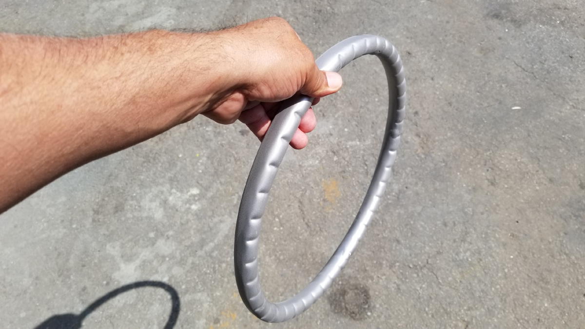

Appreciate your input Bob. Here's my version of finger indents with the help of my P50 Piranha iron worker.
Oscar
