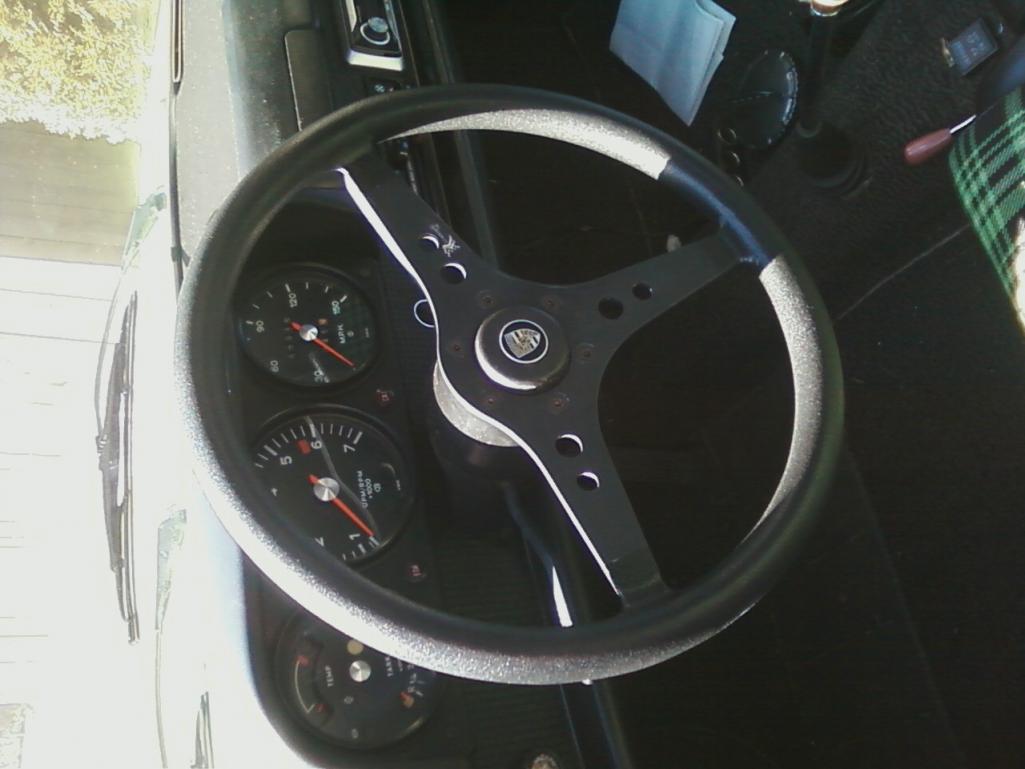

heres my modified Rial.... 370mm ,,,,914ish fashion its sprayed with bed liner..
or is it a Racemark , I did both

sixnotfour   heres my modified Rial.... 370mm ,,,,914ish fashio...   Mar 23 2019, 10:18 AM
