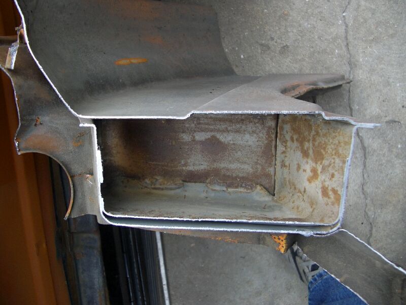

We had a sawzall party yoday and I disected a frame rail. You can see where the frame tail is folded over and welded to the shock tower.

Gint   We had a sawzall party yoday and I disected a fram...   Nov 27 2004, 06:13 PM
Gint   This is the opposite side showing how the inner fe...   Nov 27 2004, 06:15 PM
Gint   I'm the proud owner of that section of tub, so...   Nov 27 2004, 06:26 PM
