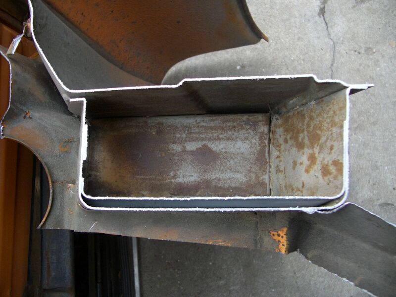

Gint
post Nov 27 2004, 06:15 PM
Mike Ginter
Posts: 16,111
Joined: 26-December 02
From: Denver CO.
Member No.: 20
This is the opposite side showing how the inner fenderwell is attached to the long or frame rail.

Gint   We had a sawzall party yoday and I disected a fram...   Nov 27 2004, 06:13 PM
Gint   This is the opposite side showing how the inner fe...   Nov 27 2004, 06:15 PM
Gint   I'm the proud owner of that section of tub, so...   Nov 27 2004, 06:26 PM
