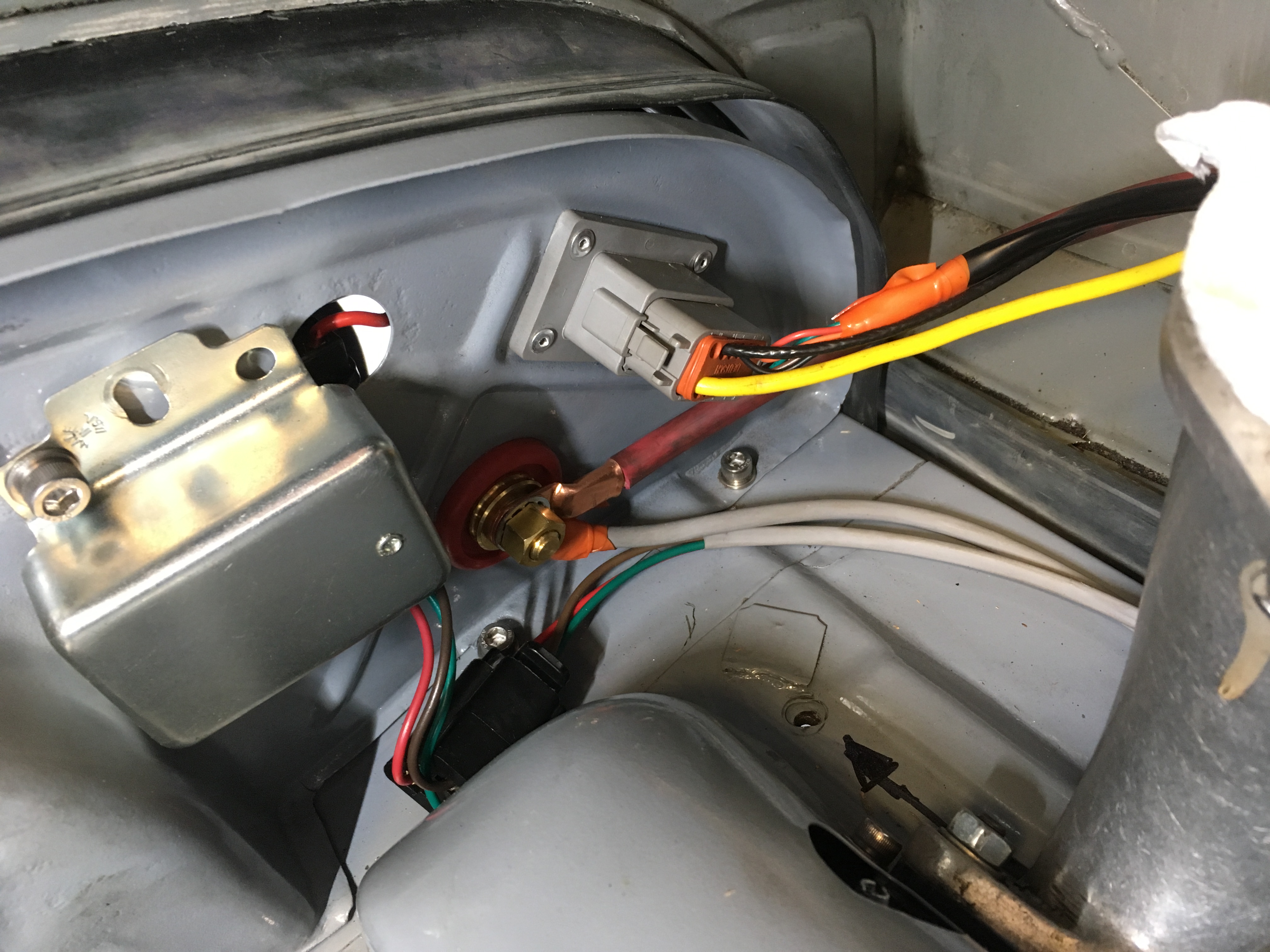

930cabman   Another old, old thread Generator light will not ...   Jul 10 2024, 04:52 PM
Spoke   Another old, old thread Generator light will not...   Jul 11 2024, 11:15 PM
930cabman   [quote name='930cabman' post='3155854' date='Jul ...   Jul 12 2024, 04:59 AM
Spoke   Thank you Spoke, this issue is with a recent /6 c...   Jul 12 2024, 07:58 AM

87m491   Not for nothing, but unless I missed it you have n...   Jul 12 2024, 06:30 AM

930cabman   Excited Still having an issue, but seems as thoug...   Jul 14 2024, 04:32 PM
Superhawk996   Excited Still having an issue, but seems as thou...   Jul 14 2024, 05:44 PM
930cabman   [quote name='930cabman' post='3156695' date='Jul ...   Jul 15 2024, 11:29 AM
Superhawk996   When you say blue wire has nothing on it is th...   Jul 15 2024, 12:57 PM
930cabman   [quote name='930cabman' post='3156853' date='Jul ...   Jul 15 2024, 01:00 PM
Superhawk996   maybe the bulb wattage is not allowing the alte...   Jul 15 2024, 01:14 PM
930cabman   maybe the bulb wattage is not allowing the alt...   Jul 15 2024, 01:20 PM
Superhawk996   After a few blips she starts charging and stays...   Jul 15 2024, 01:33 PM
Spoke   Excited Still having an issue, but seems as thou...   Jul 15 2024, 08:23 AM
930cabman   Excited Still having an issue, but seems as tho...   Jul 15 2024, 09:21 AM
930cabman   Got it, mostly. As you can imagine this has been d...   Jul 15 2024, 04:25 PM
Superhawk996   Got it, mostly. As you can imagine this has been ...   Jul 15 2024, 05:02 PM
930cabman   Got it, mostly. As you can imagine this has been...   Jul 15 2024, 06:19 PM
