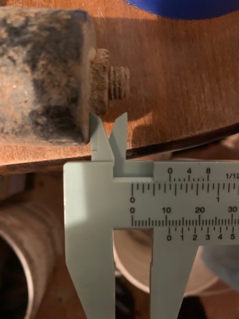

@bbrock Brent, I just came across this thread. FYI, as more datum, below is a pic of my pressure regulator (that has probably never been adjusted, and certainly hasn't been adjusted for 35 years) and the adjuster appears to be at about 11mm.
