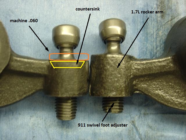

So those in the know...how is this conversion done? I don't now the specifics so please tell me. I understand that the stock 74-76 2.0L cars use a larger-diameter adjuster and cannot accept the swivel foot adjusters because they are smaller. The needed parts as I understand it are:
* Rocker arms/shaft assemblies from a 1.7L engine
* Swivel feet valve adjusters (10mm?)
* Shims
Is all the above correct?
What shims do I need and where are they installed?
Is there further machining to do to the rocker arms?
All details please...Thanks in advance (IMG:style_emoticons/default/biggrin.gif)

I thought Id update the descriptive image. (IMG:style_emoticons/default/smile.gif)

Twystd1   Yup... You have the right parts. Now you need to ...   Jan 10 2007, 06:32 PM

gregrobbins   Here's a photo I copied from somewhere.   Jan 10 2007, 08:47 PM
Twystd1   Thats the exact photo I was searching for..... Th...   Jan 10 2007, 08:52 PM

Aaron Cox   You need to clearance 60 tho off the rocker face. ...   Feb 26 2007, 10:10 PM
CHAFF   Thanks Aaron, that answers it. You need to clear...   Feb 26 2007, 10:22 PM

maf914   Rich, Nice clarification to the earlier posted pho...   Dec 23 2019, 06:42 AM
914Sixer   10mm swivel foot German adjusters are now availabl...   Dec 23 2019, 11:35 AM
914werke   good to know, source?   Dec 23 2019, 03:17 PM
bbrock   Here's a machining service and source for swiv...   Dec 23 2019, 05:15 PM
nditiz1   They worked out great. I saw no issues while usin...   Jan 1 2020, 05:33 PM
Mark Henry   Yes you have to machine and countersink the rocker...   Jan 3 2020, 08:51 AM
