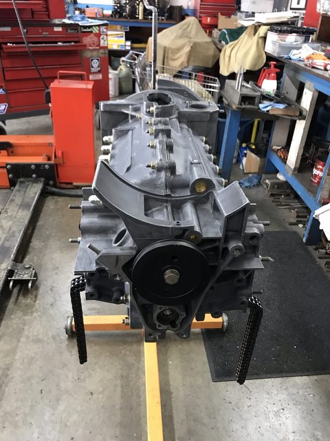

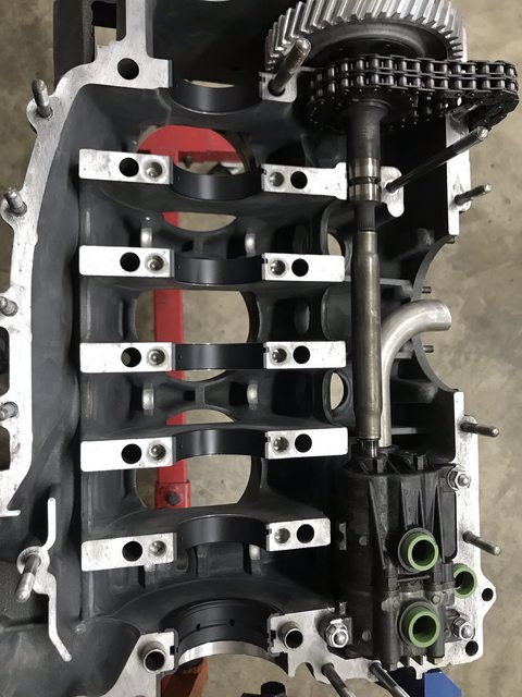

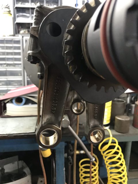

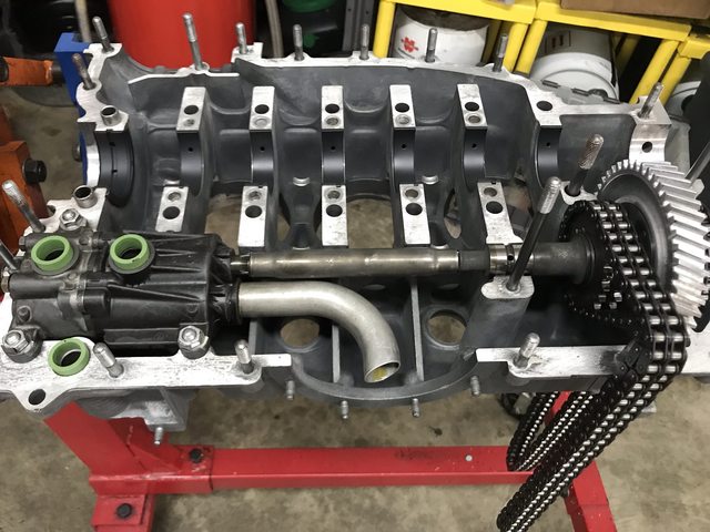

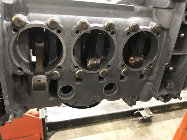

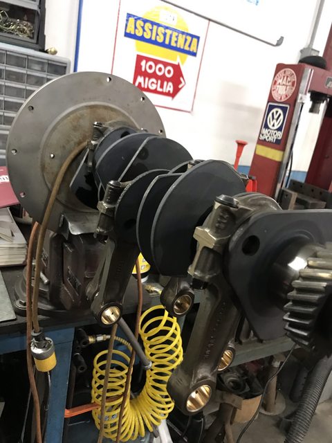

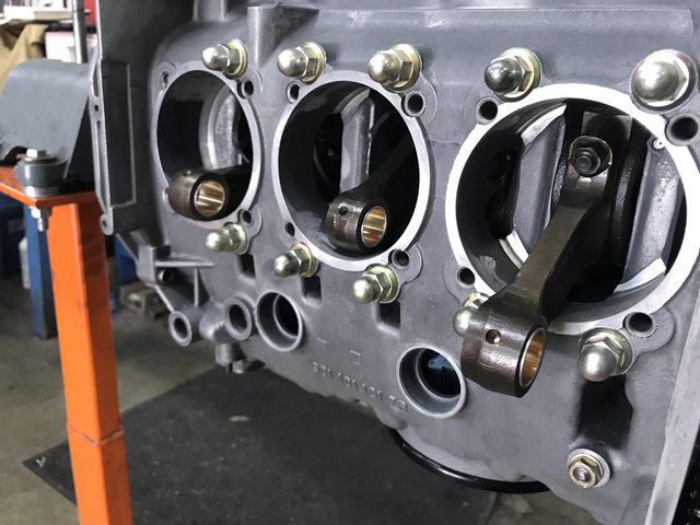

So much work has been done since my last post. Here's a quick roundup:
Rebuilt the lower case, new bearings, oil bypass mods
(IMG:http://www.914world.com/bbs2/uploads_offsite/i.imgur.com-21443-1580700666.1.jpg)

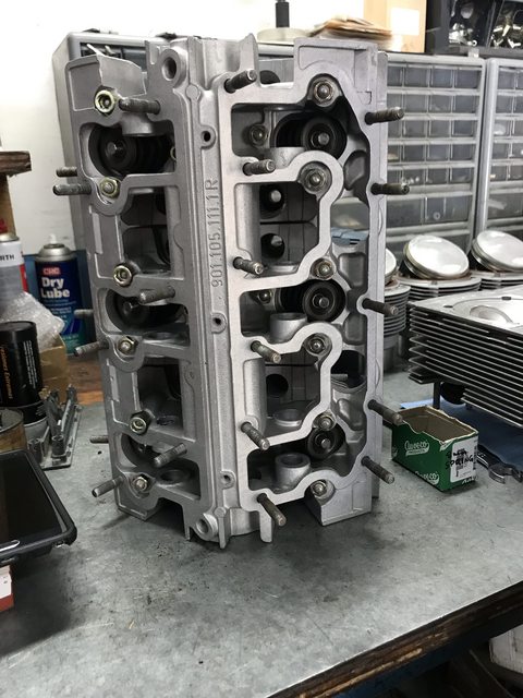

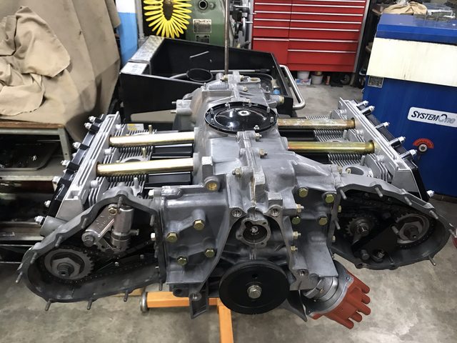

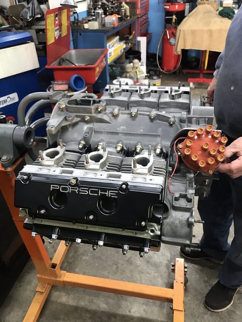

Heads competed and engine assembled
