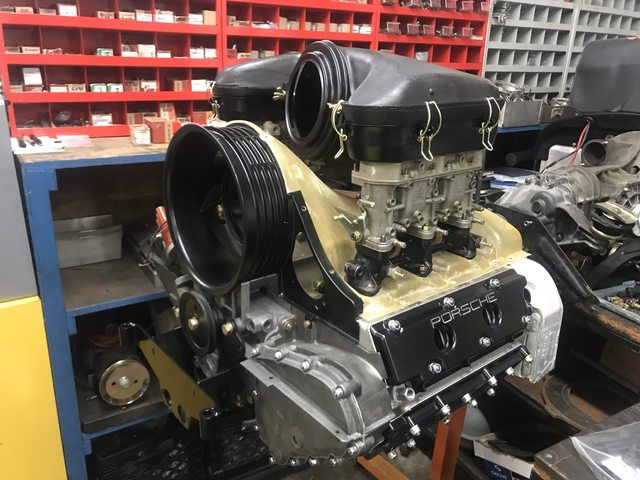

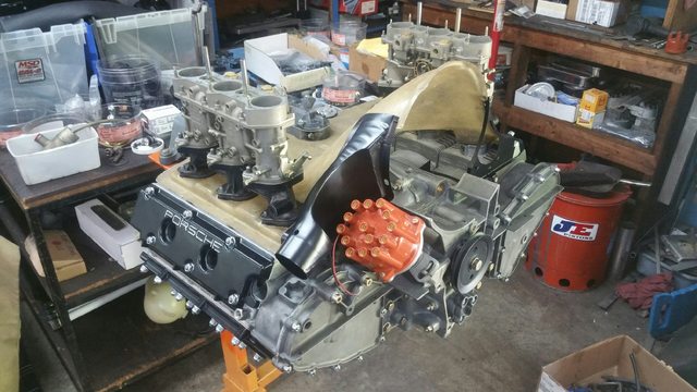

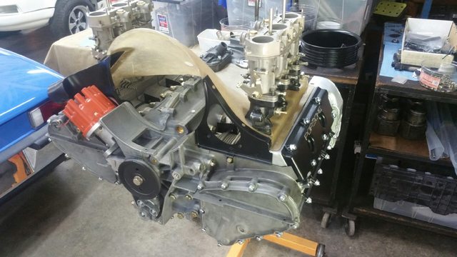

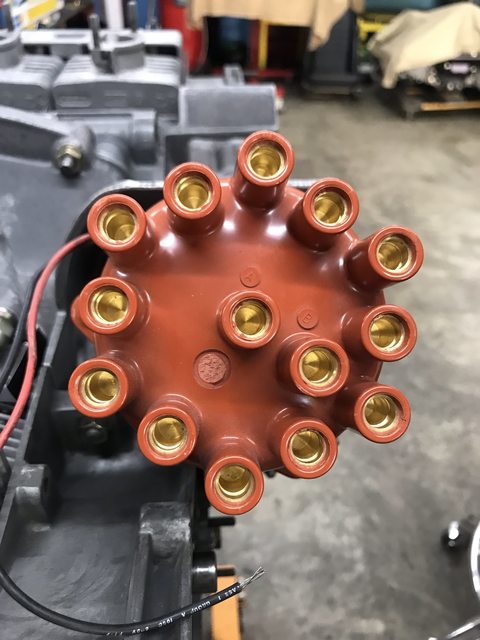

Distributor and cap installed, and engine finished. It looks amazing, and I can't wait to hear it.
(IMG:http://www.914world.com/bbs2/uploads_offsite/i.imgur.com-21443-1580701313.1.jpg)
(IMG:http://www.914world.com/bbs2/uploads_offsite/i.imgur.com-21443-1580701313.2.jpg)
(IMG:http://www.914world.com/bbs2/uploads_offsite/i.imgur.com-21443-1580701314.3.jpg)
(IMG:http://www.914world.com/bbs2/uploads_offsite/i.imgur.com-21443-1580701314.4.jpg)

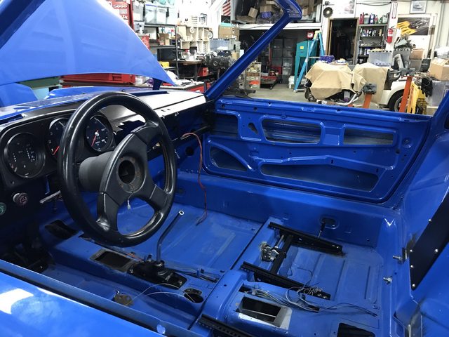

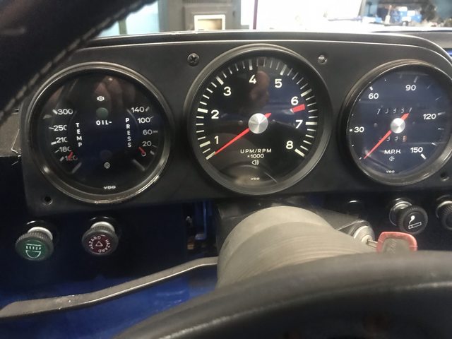

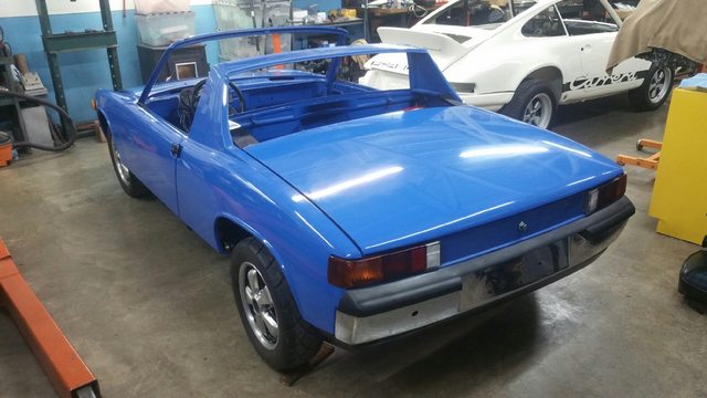

Interior received some love. Instruments and harness wired in
(IMG:http://www.914world.com/bbs2/uploads_offsite/i.imgur.com-21443-1580701314.5.jpg)
(IMG:http://www.914world.com/bbs2/uploads_offsite/i.imgur.com-21443-1580701314.6.jpg)
(IMG:http://www.914world.com/bbs2/uploads_offsite/i.imgur.com-21443-1580701314.7.jpg)

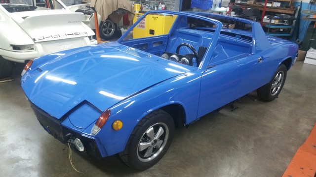

Rear tail lamps added
(IMG:http://www.914world.com/bbs2/uploads_offsite/i.imgur.com-21443-1580701314.8.jpg)

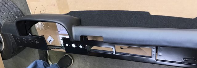

Dash turned out great, thanks to 914Rubber
(IMG:http://www.914world.com/bbs2/uploads_offsite/i.imgur.com-21443-1580701912.1.jpg)

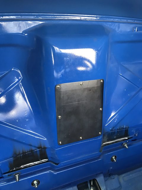

Access panel cut in the firewall to ease belt replacement
(IMG:http://www.914world.com/bbs2/uploads_offsite/i.imgur.com-21443-1580701912.2.jpg)

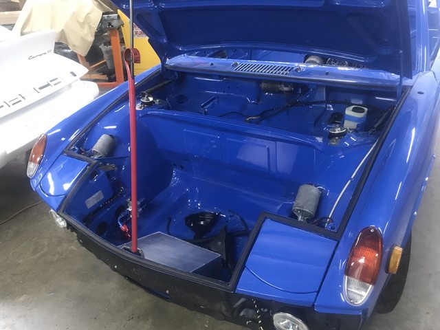

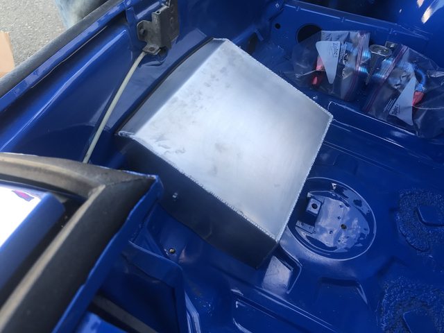

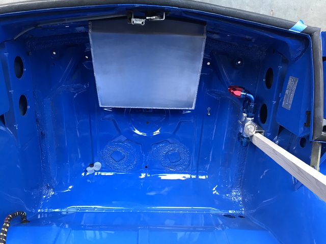

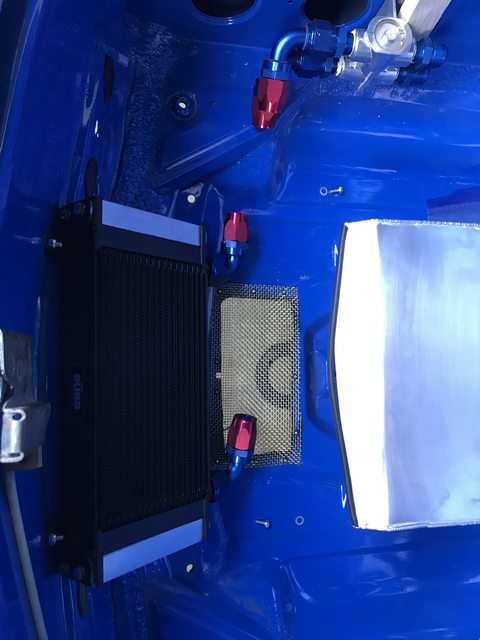

Front oil cooler installed with lines, and custom shroud finished
(IMG:http://www.914world.com/bbs2/uploads_offsite/i.imgur.com-21443-1580701913.3.jpg)
(IMG:http://www.914world.com/bbs2/uploads_offsite/i.imgur.com-21443-1580701913.4.jpg)
(IMG:http://www.914world.com/bbs2/uploads_offsite/i.imgur.com-21443-1580701913.5.jpg)
(IMG:http://www.914world.com/bbs2/uploads_offsite/i.imgur.com-21443-1580701913.6.jpg)

rgalla9146   Beautiful work. Where did you source the distrib...   Feb 3 2020, 10:51 AM
davehg   Beautiful work. Where did you source the distri...   Feb 3 2020, 08:43 PM

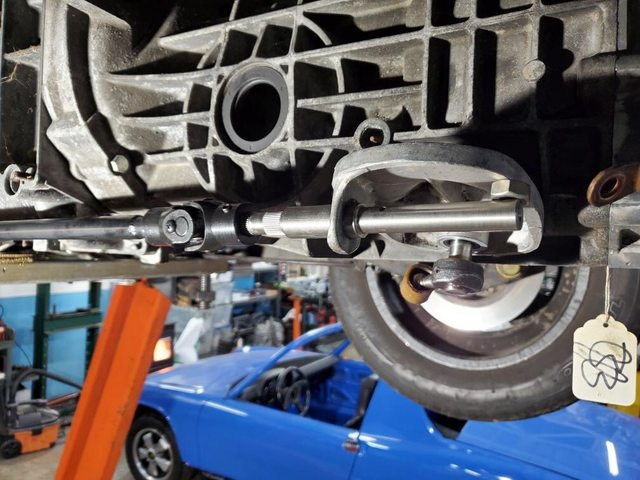

davehg   Turning to the transmission, it was completely reb...   Nov 11 2023, 02:03 PM
