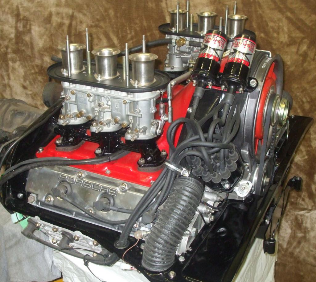

QUOTE(rgalla9146 @ Feb 3 2020, 11:51 AM) *
Beautiful work.
Where did you source the distributor, cap and rotor ?
(IMG:style_emoticons/default/agree.gif) Is that a stock OE Jag cap? I could never find one, mine uses a aftermarket black cap. I've heard these can have issues but so far no problems.
On thing that will piss you off is you can't see that beautiful dizzy once in the teen. (IMG:style_emoticons/default/dry.gif)
My 3.0
(IMG:http://www.914world.com/bbs2/uploads/post-26-1497554034_thumb.jpg)
