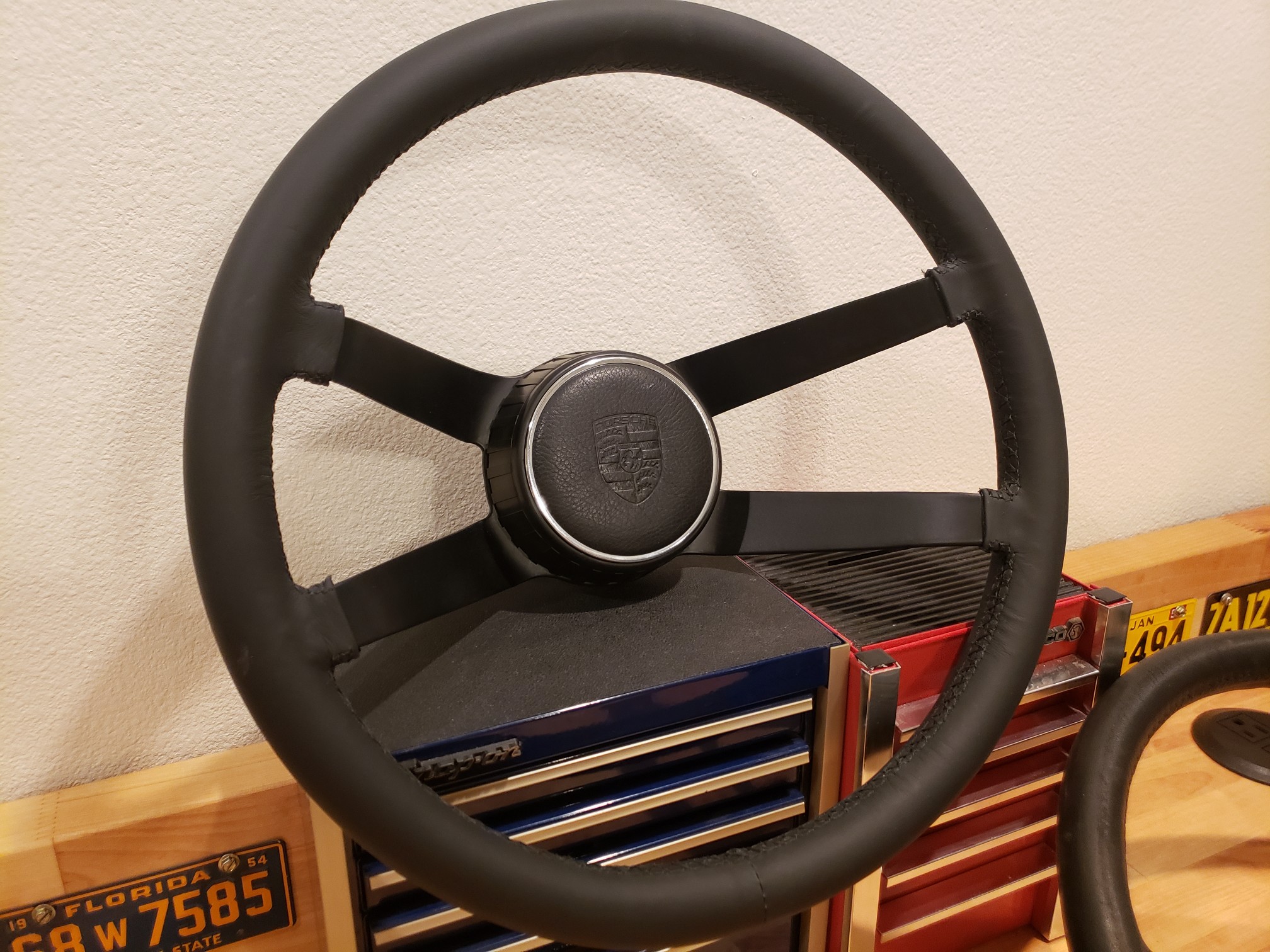

I like these steering wheels with RS / GT type centers but even the 360mm Dia wheels are a tad big IMO
Honey...I'm shrinking my steering wheel. (IMG:style_emoticons/default/happy11.gif)
To be continued.....

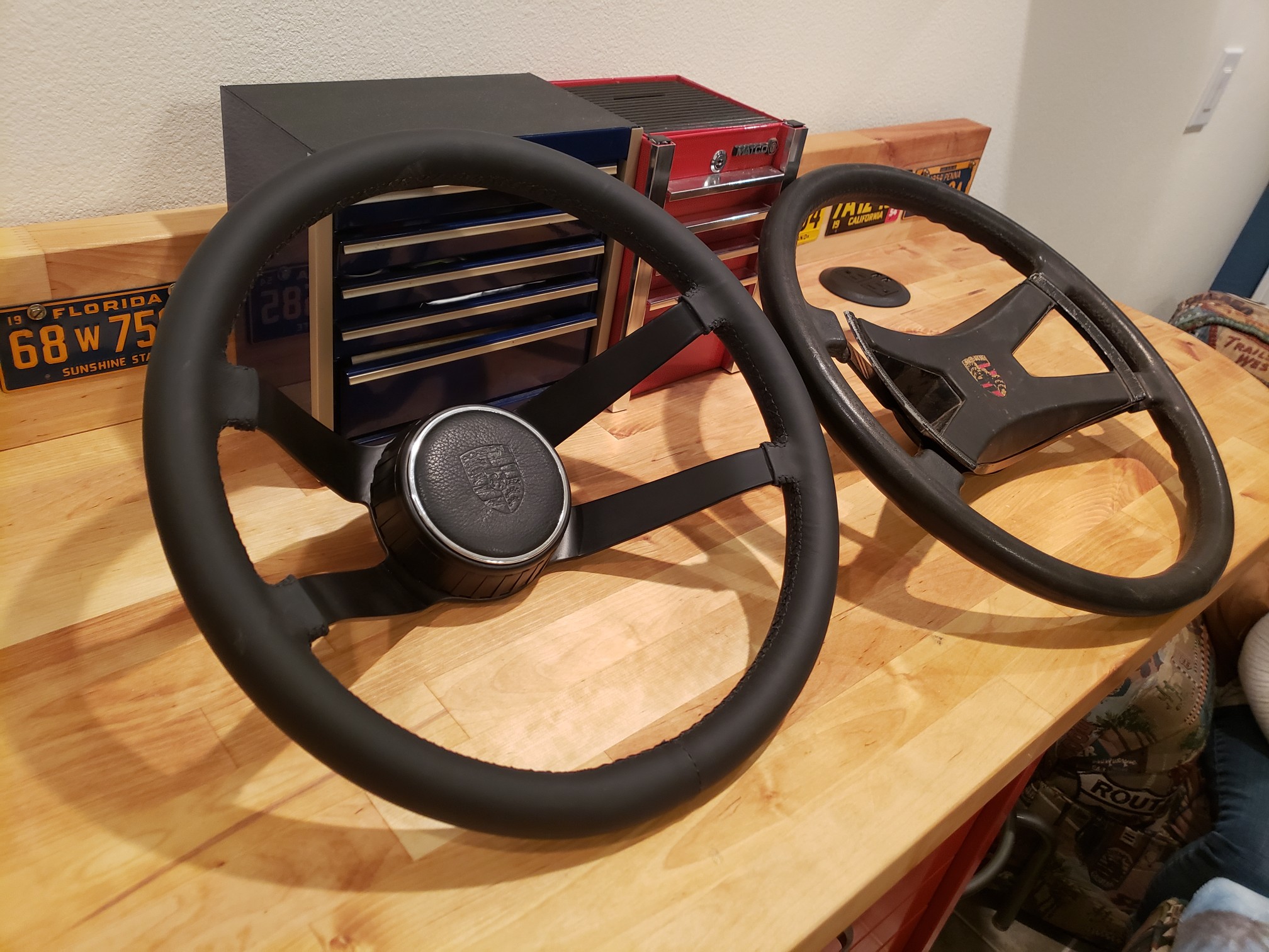

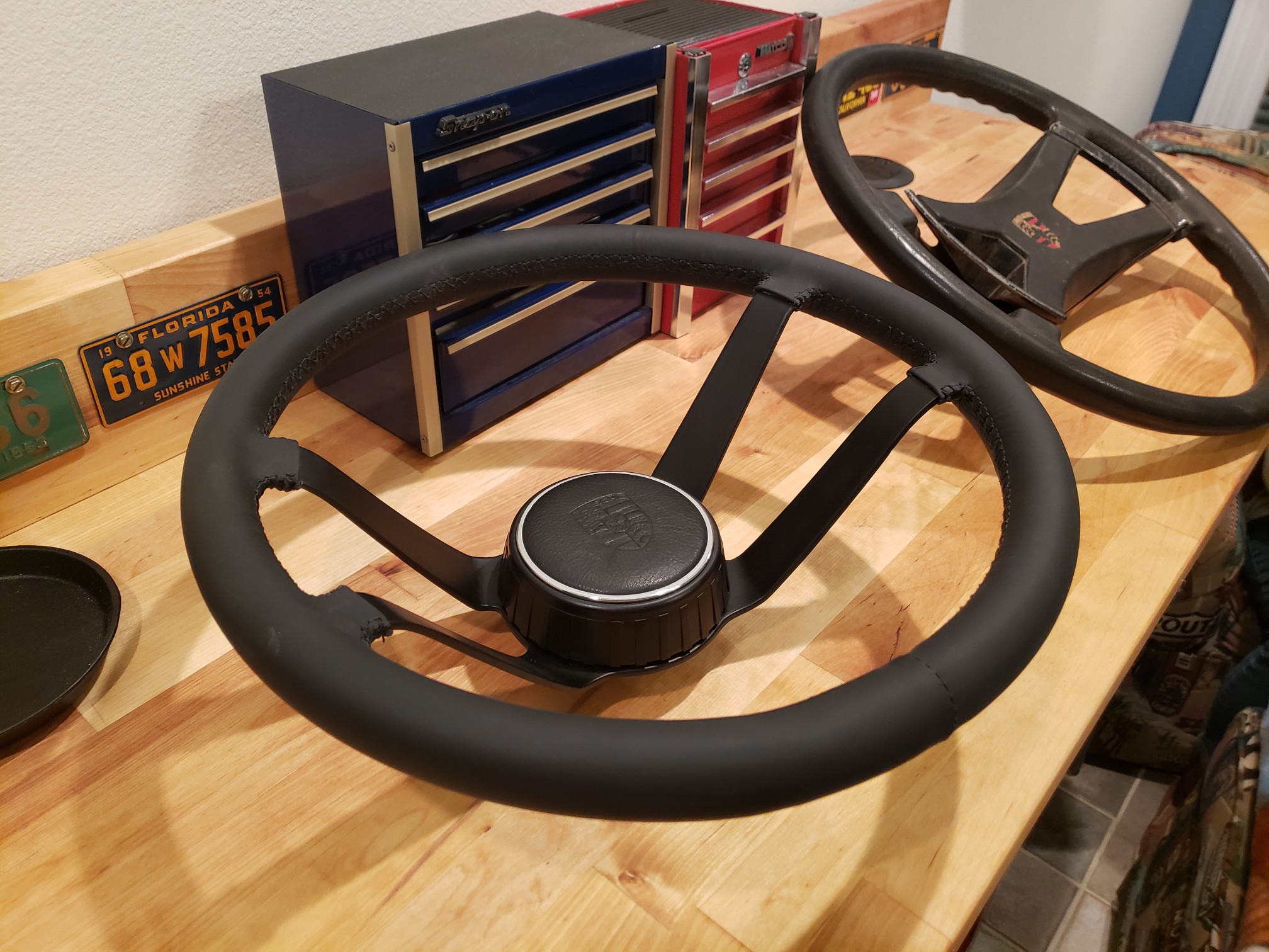

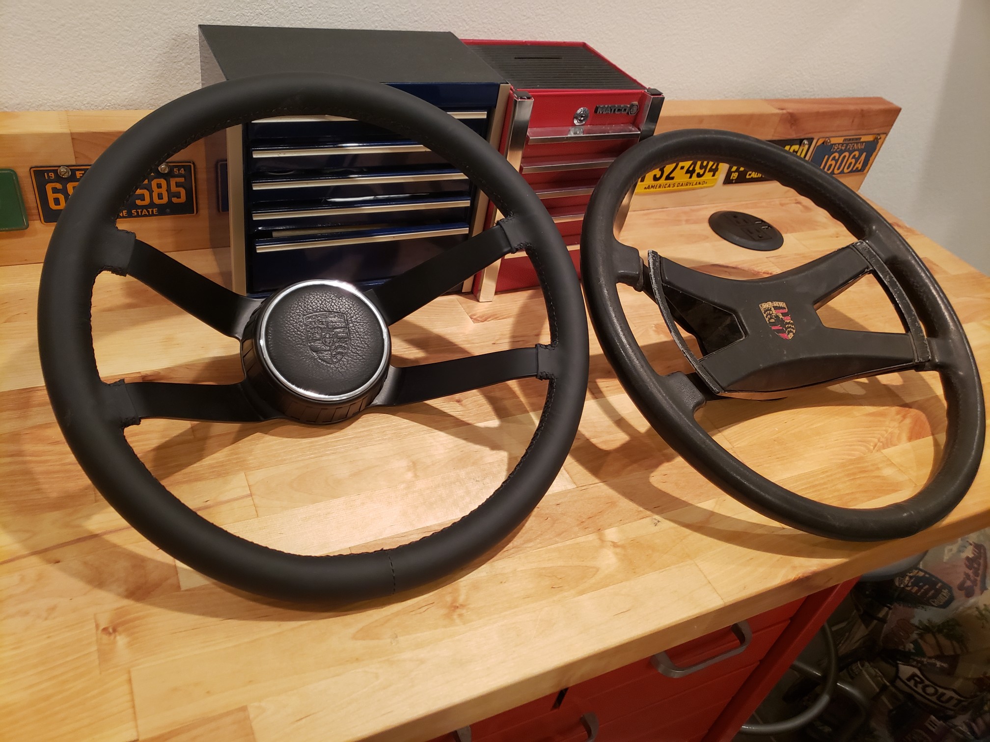

One finished.... (IMG:style_emoticons/default/dance.gif) (IMG:style_emoticons/default/monkeydance.gif)
30mm Grip/1.25" w leather covering
340mm Diameter/ 13.5"
40mm/1.5" Dished deeper than stock

ValcoOscar   More photos showing size differences. Opted not t...   Mar 19 2019, 09:39 PM
Retroracer   Looks great Oscar! How did you roll the outer?...   Mar 19 2019, 09:55 PM

ValcoOscar   It took me several attempts and unfortunately I sc...   Mar 20 2019, 08:27 AM
Mark Henry   It took me several attempts and unfortunately I s...   Mar 20 2019, 08:46 AM
gereed75   My plan was to cut the rim portion out of flat sto...   Mar 20 2019, 08:43 AM
ValcoOscar   My plan was to cut the rim portion out of flat st...   Mar 20 2019, 08:49 AM
