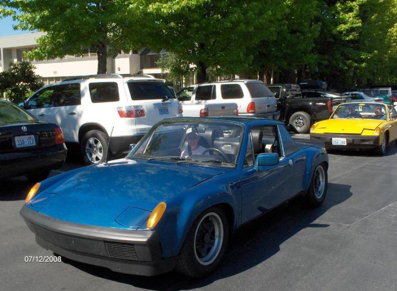

Michelle and I picked up our new to us 914-6 over the weekend. We practiced social distancing and kept safe. Two days home, 920 miles, the 914 never missed a beat.
Here's a picture at a rest stop about 30% of the way home.

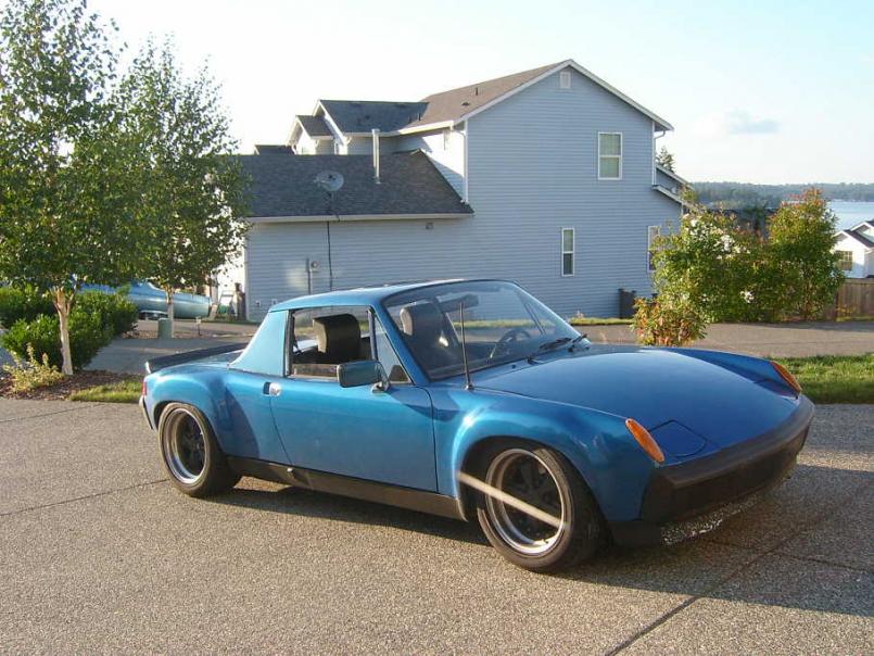

jim_hoyland   Nice Dan,HAVE FUN :) Remember this beauty....   Apr 8 2020, 04:52 PM
Root_Werks   Nice Dan,HAVE FUN :) Remember this beauty.... ...   Apr 9 2020, 08:36 AM

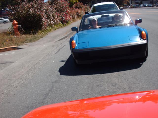

Bleyseng   a pic from awhile ago   Apr 22 2020, 12:05 PM
Root_Werks   If memory serves, I believe I was picking up a sol...   Apr 22 2020, 12:23 PM
