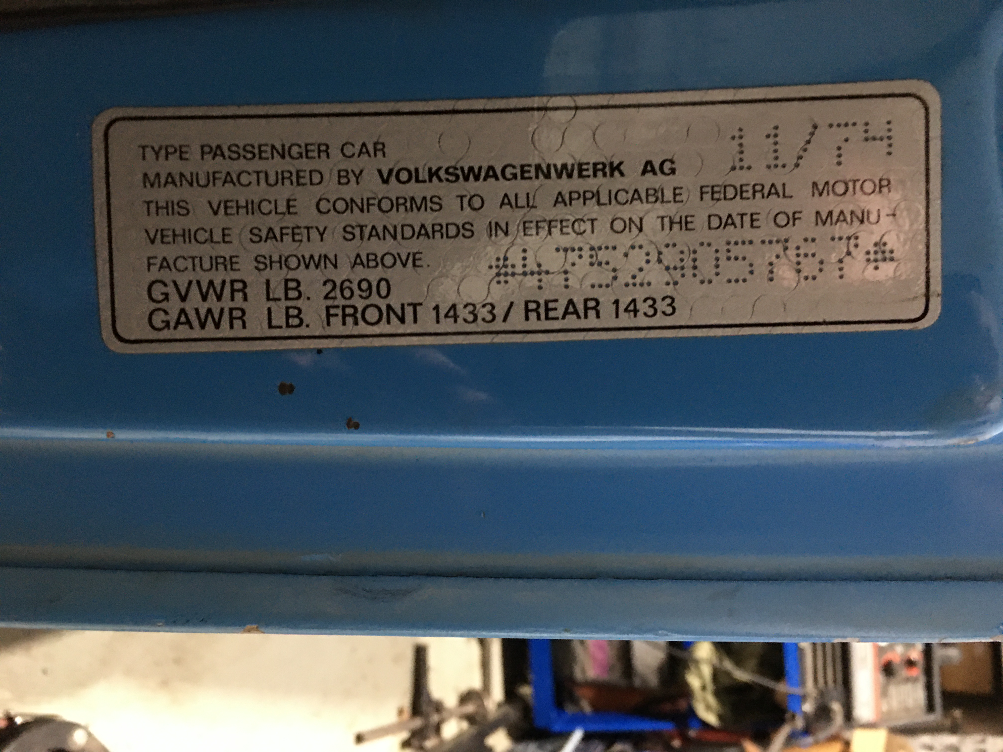

And this is why the paint/color change will happen sooner than later. Yes, you can see instead of painting red in things like trunks and door jams, there is brushed on black paint.
Looks like someone tried to clean around the VIN sticker (New on already one the way from Car-Bone.pl) and destroyed it.
I'm hoping this year I'll get the 914 stripped down and painted back to the original Anacona Blue.

QUOTE(Root_Werks @ Apr 8 2020, 07:24 AM) *
And this is why the paint/color change will happen sooner than later. Yes, you can see instead of painting red in things like trunks and door jams, PO took some sort of paint and a brush and went to town.
He tried to clean around the VIN sticker (New on already one the way from Car-Bone.pl) and destroyed it.
Your car must be early November and mine later. Few hundred apart but still siblings I suppose. Mine is laguna blau.
