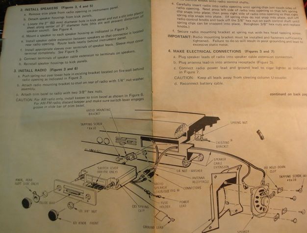

This should help with wiring. This is installation instruction for Motorola Sapphire.

Mike Fitton   This should help with wiring. This is installation...   Aug 9 2020, 07:33 PM
