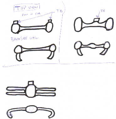

for my 2316 it seems that the stock plenum might be reaching it's limits as far as volume goes.....so, I either fabricate a larger common plenum, or go with individual throttle bodies such as TWM or Jenvey*
single plenum would be easiest, but the individual throttle bodies look better (IMG:style_emoticons/default/smile.gif)
has anyone switched from one to the other on the same motor with everything else being the same???

QUOTE(Aaron Cox @ Dec 18 2004, 12:42 PM)
heres a wild thought....use carb manifolds.... weld injector bungs on them.... make a common air box that has a throttlebody on it and connect it to the two carb manifolds (IMG:style_emoticons/default/wink.gif)
that is sorta what Andy posted...the question(s) is how to make the plenum and of what design?
here is my 1st grade type sketches

Aaron Cox   heres a wild thought....use carb manifolds.... wel...   Dec 18 2004, 01:42 PM

Aaron Cox   beautiful drawings :trophy: pony up for the jen...   Dec 18 2004, 02:24 PM
