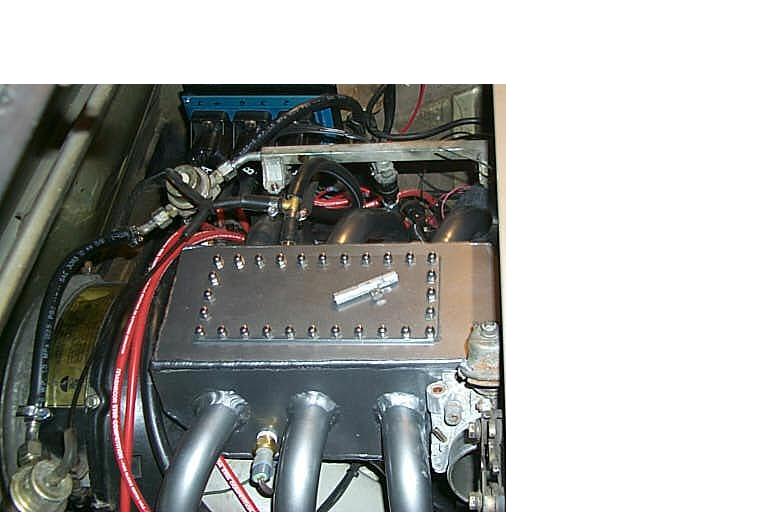

914efi   This is what I built for my 2.2E engine. It seems ...   Dec 19 2004, 08:37 AM
Mueller   914efi, nice DIY job :trophy: a couple of quest...   Dec 19 2004, 12:21 PM
