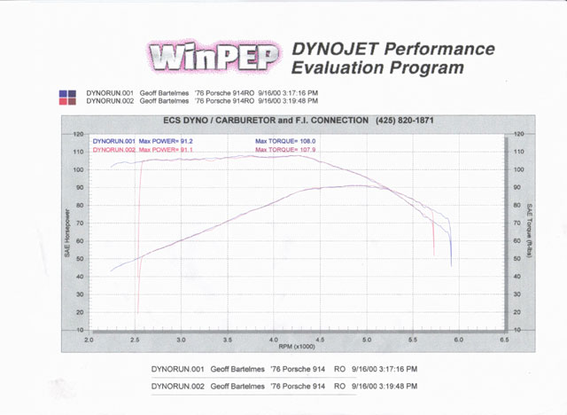

Bleyseng   <...   Dec 16 2004, 10:41 PM

Bleyseng   air velocity I think. Under lite vacuum at cruisin...   Dec 16 2004, 11:01 PM
