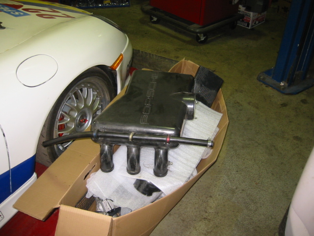

TimT   Mike the GT3RS we just tore down has a big box ple...   Dec 18 2004, 02:09 PM

TimT   Mike here is the GT3RS plenum, I couldnt find wher...   Dec 20 2004, 04:19 PM
TimT   nuther   Dec 20 2004, 04:20 PM
TimT   YOu bolt the different restrictors to that round ...   Dec 20 2004, 04:22 PM
Mueller   thanks Tim, that is a huge plenum...and dusty to...   Dec 20 2004, 04:48 PM

Mueller   concrete dust?? that is even worse....... can you...   Dec 20 2004, 10:08 PM
Bleyseng   Check out how short those runners are! Nice ca...   Dec 20 2004, 11:33 PM
