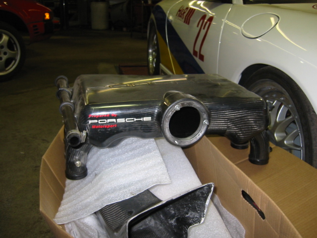

TimT   Mike the GT3RS we just tore down has a big box ple...   Dec 18 2004, 02:09 PM

TimT   Mike here is the GT3RS plenum, I couldnt find wher...   Dec 20 2004, 04:19 PM
TimT   nuther   Dec 20 2004, 04:20 PM
TimT   YOu bolt the different restrictors to that round ...   Dec 20 2004, 04:22 PM
Mueller   thanks Tim, that is a huge plenum...and dusty to...   Dec 20 2004, 04:48 PM

Bleyseng   Check out how short those runners are! Nice ca...   Dec 20 2004, 11:33 PM

Bleyseng   Mueller, I too after seeing that CF manifold thoug...   Dec 21 2004, 09:12 AM
Jake Raby   My Carbon Fiber tech has been on the plenum for qu...   Dec 21 2004, 09:37 AM
Bleyseng   Ah, but the question here is- Is the carbonfiber m...   Dec 21 2004, 09:54 AM

Qarl   I don't think the carbon fiber plenum needs to...   Dec 21 2004, 03:37 PM
