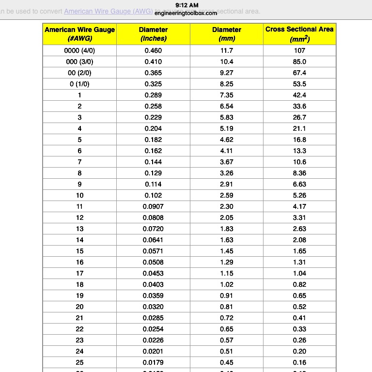

0.5 mm^2 converts to 20 gage
1.0 mm^2 converts to 16 gage

Jeff now I'm confused. I checked a number of sites, like Rawell and 2-3 others and their conversion table shows that 1.0mm2 converts up to a 16ga wire which is actually 1.29 to 1.31mm2. The fact that i'm using GXL wire does that a different? Do you have a conversion chart that you could share? Any help would be appreciated.
This is the conversion table I downloaded from "engineeringtoolbox.com"Attached Image
