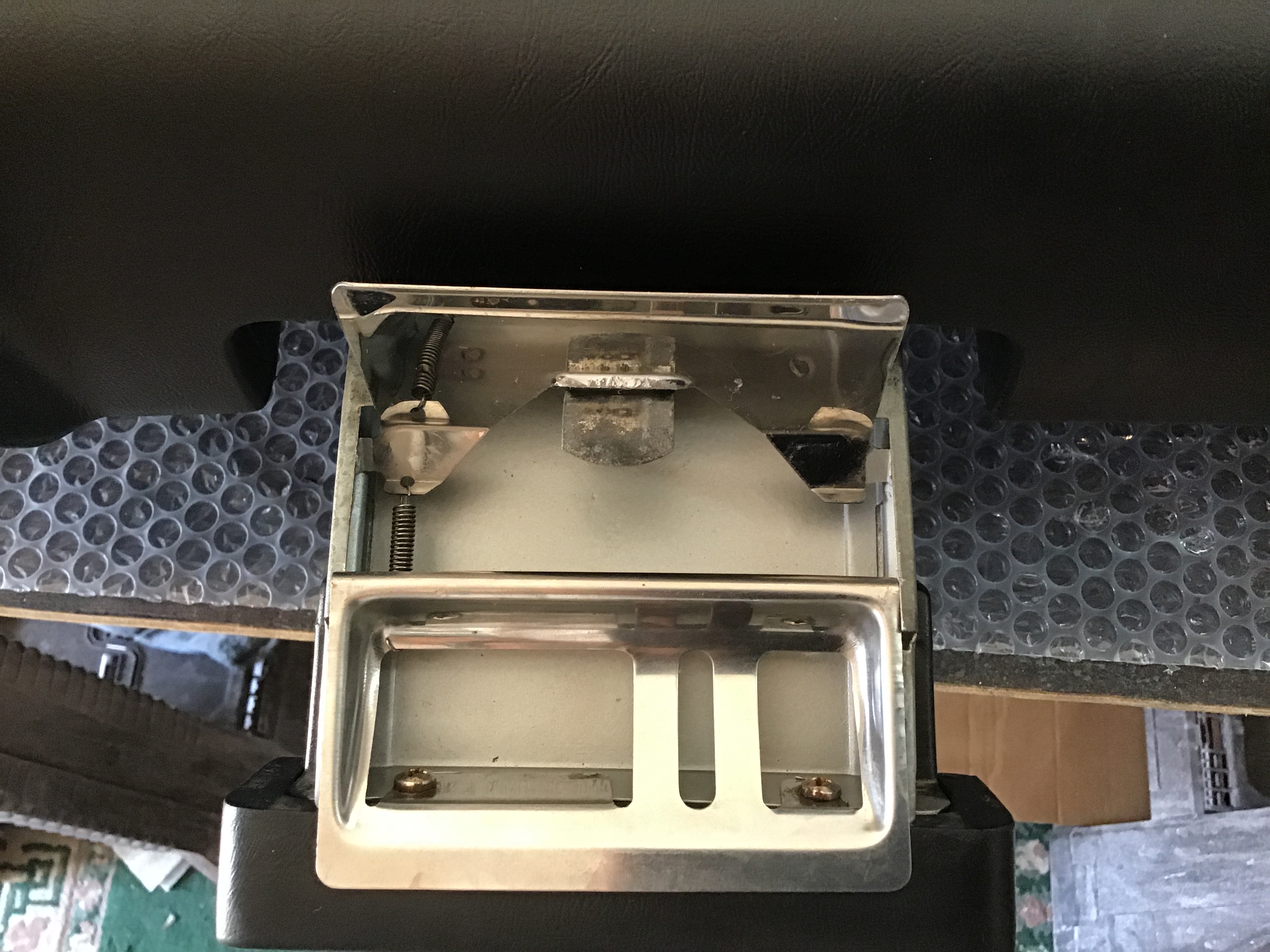

I was able to get the dash top installed today. I’m pretty happy with the with the final results. I completely freshened up the dash including, basket weave on the front, padding and new vinyl on the top , and finally the dash top. All materials came from 914 Rubber.
The ash trey cleaned up fairly well
