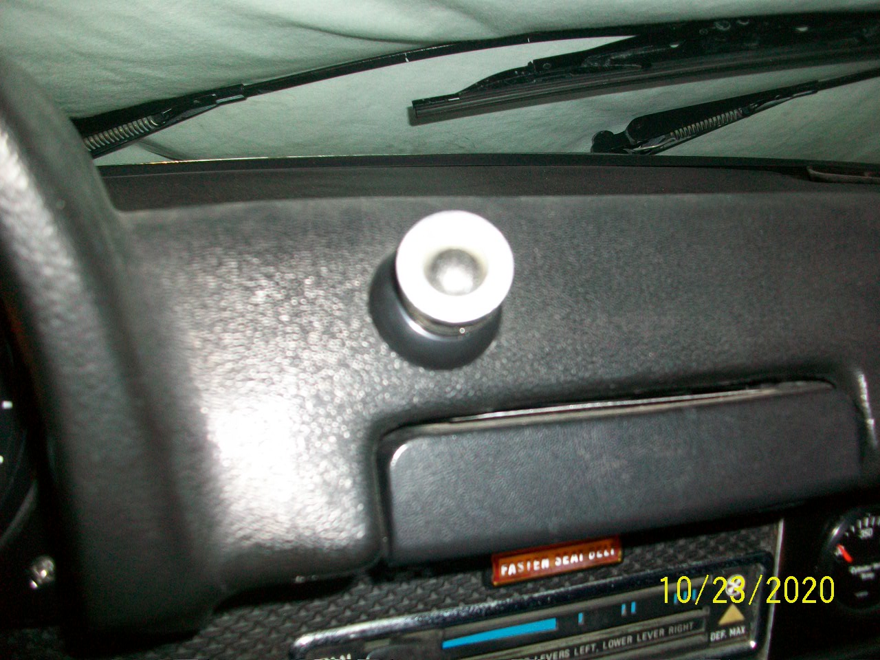

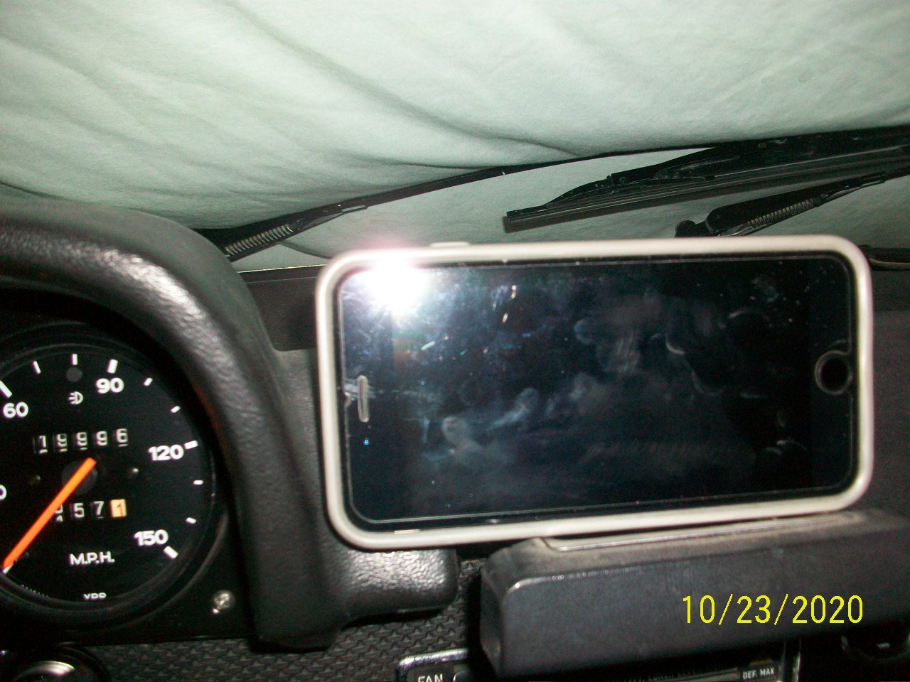

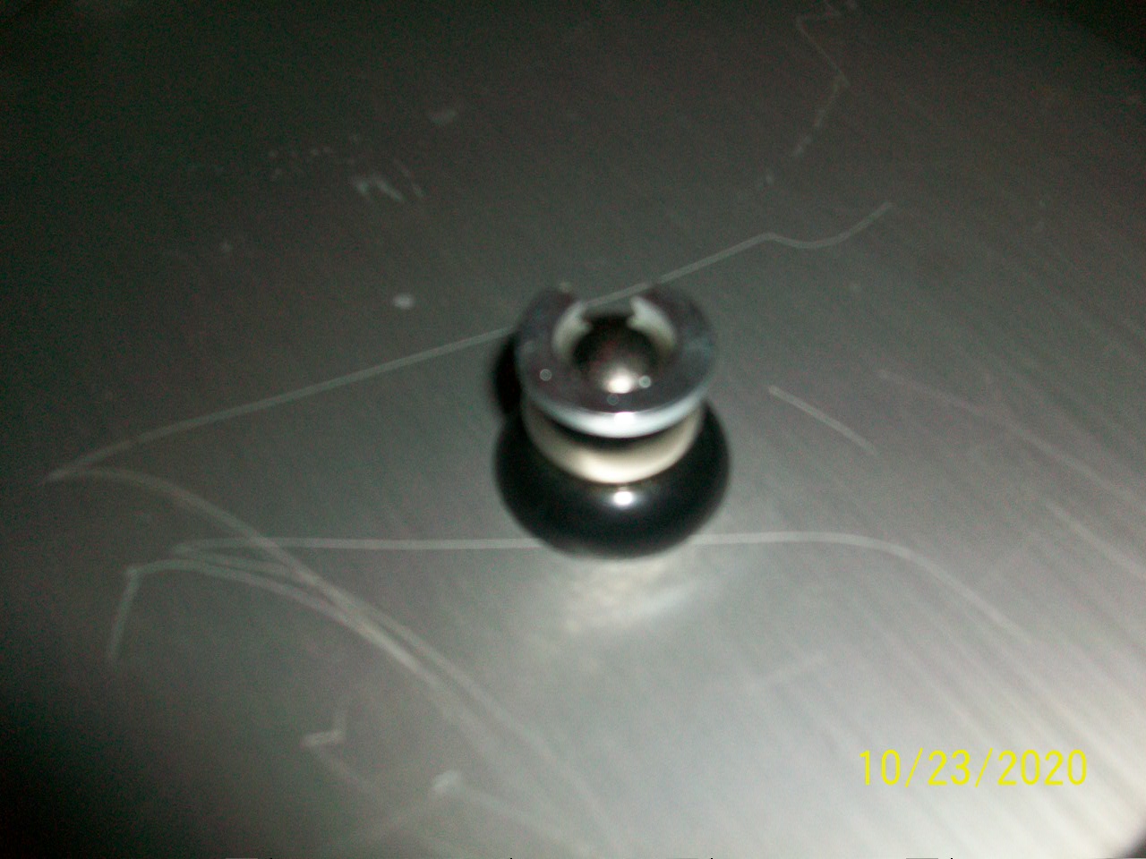

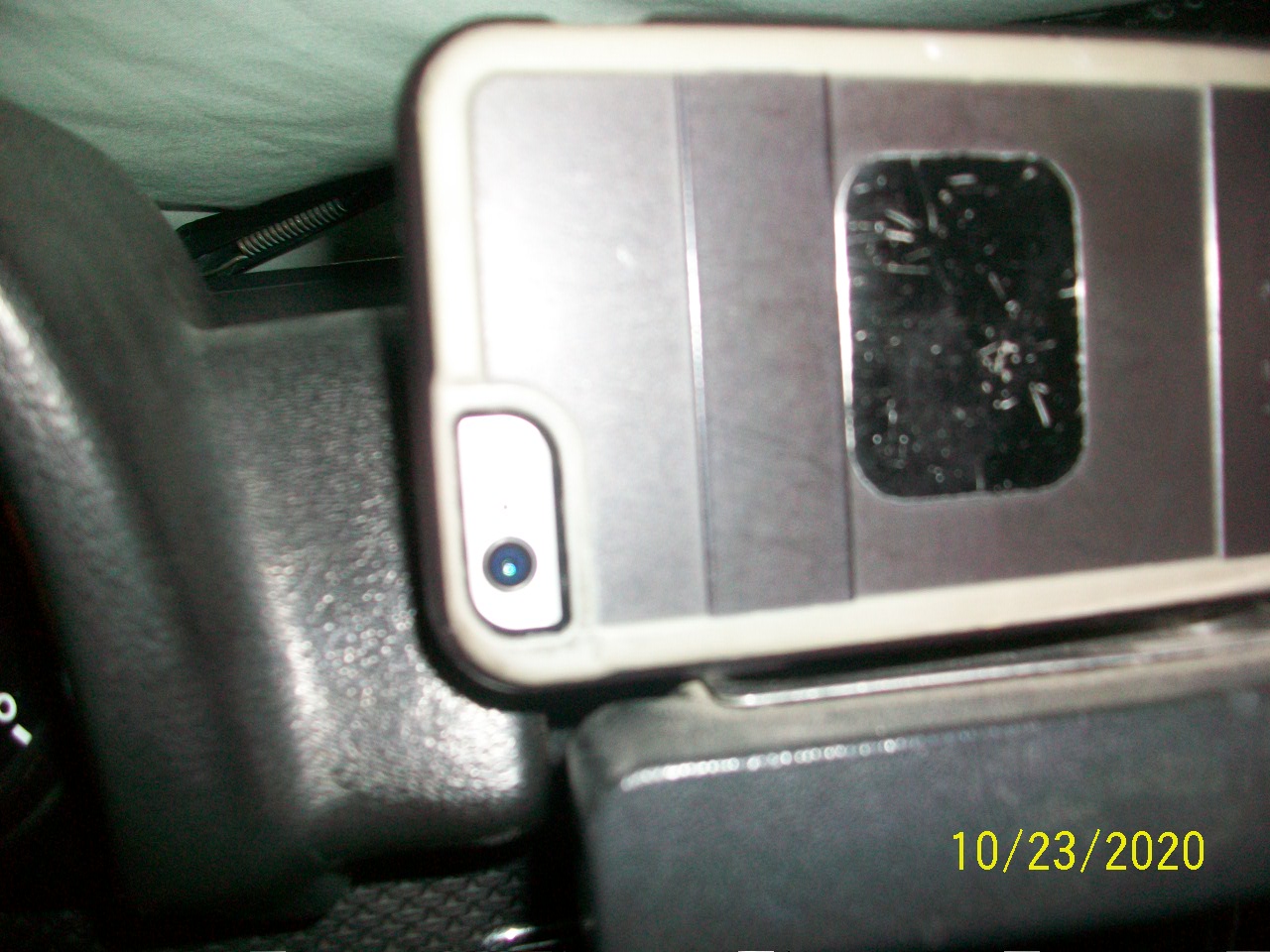

here's an alternative solution I've employed. The caveat is that the magnet is attached with double stick tape to the dash surface. In my case, I have a dash cover, so I'm not worried about ruining the face of my dash vinyl. 1. Source out a magnetic type mount that pivots. 2. Source out the steel plates that attach to the back of your phone. Both these items were sourced from eBay. The extended dash tray is the support of my phone. Here are the pics
