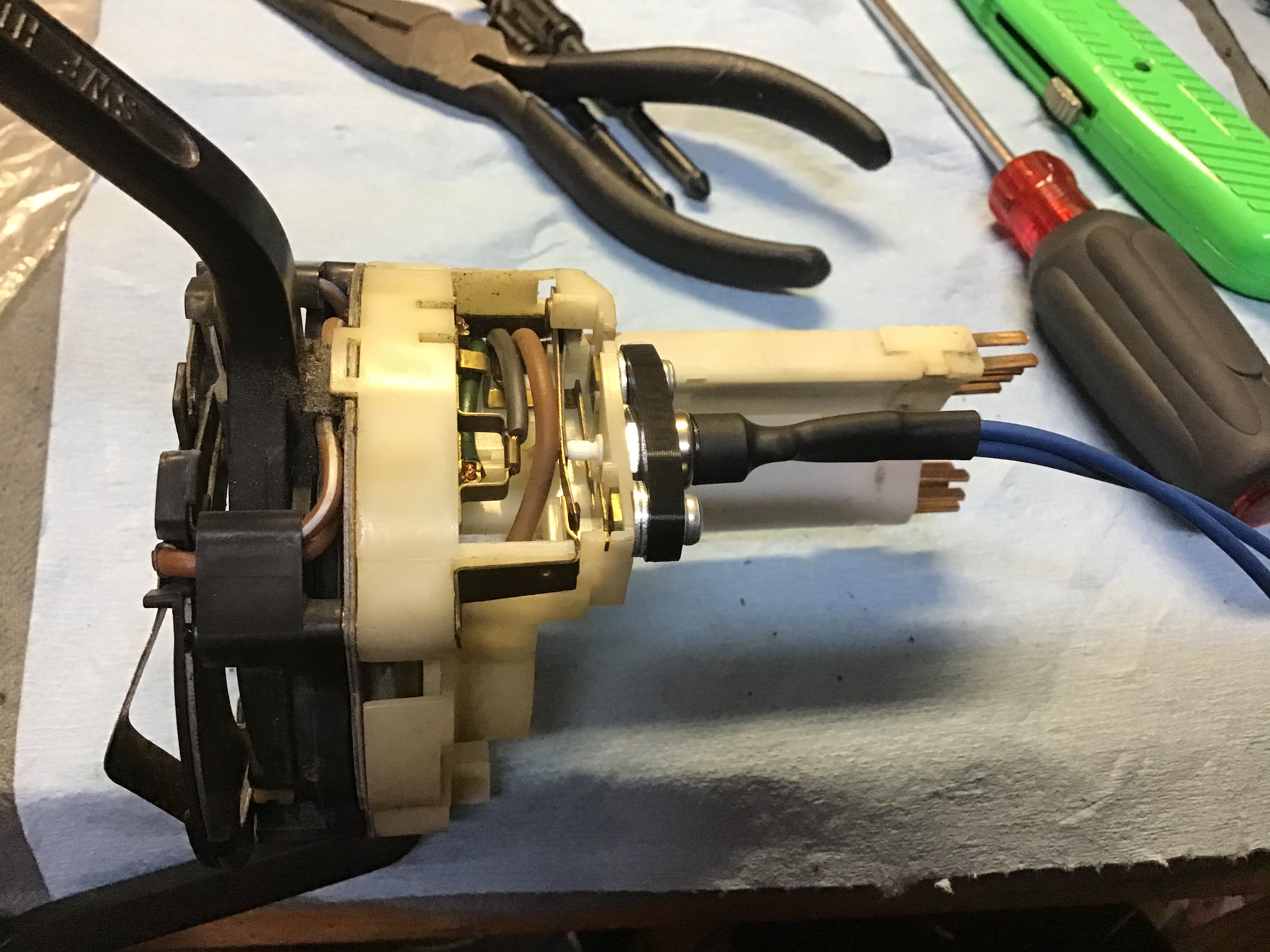

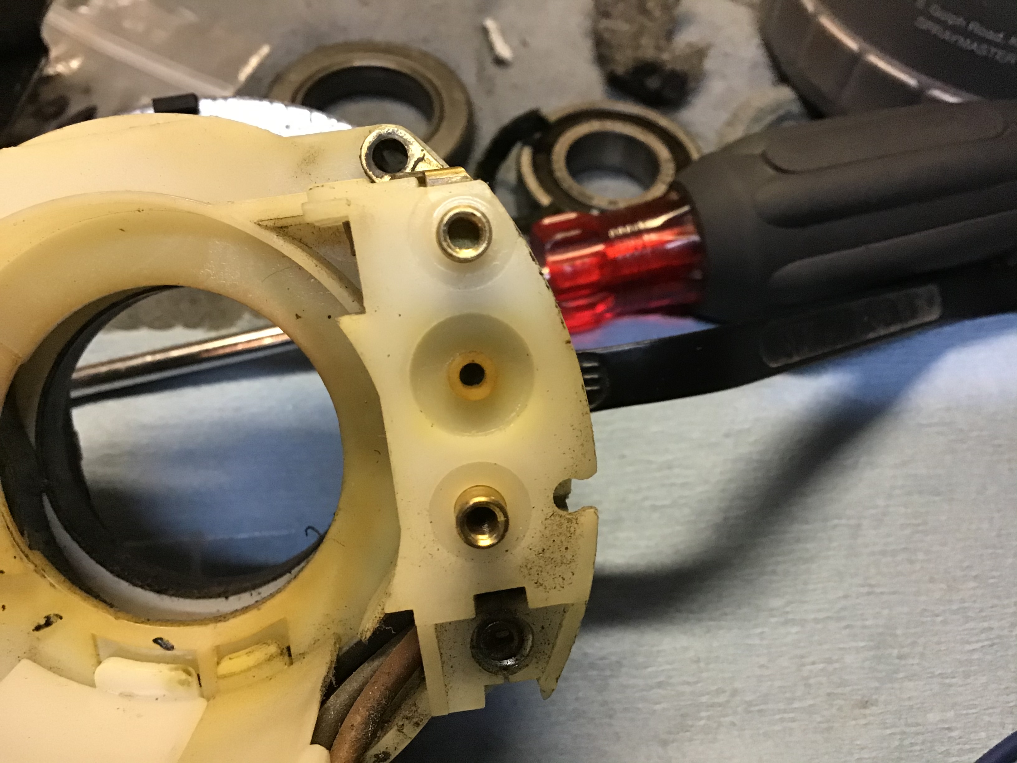

I received my carmagic switch for the windshield washer pump today. Let’s see how this baby fits.
First order of business is to remove the old valve, enlarge the center hole with a 4 mm drill bit and install the new switch.
Like an idiot I forgot to take a picture of the drilled out hole, but you get the idea. Even though I was very careful when drilling, the hole ended up a bit off center so the switch would not fit until I wallowed out the holes a bit.
Here is where I could use some help, I have looked at the electrical schematic and not sure how to wire this. I really don’t want to add a relay if possible. Maybe someone who has done this conversion could chime in.
